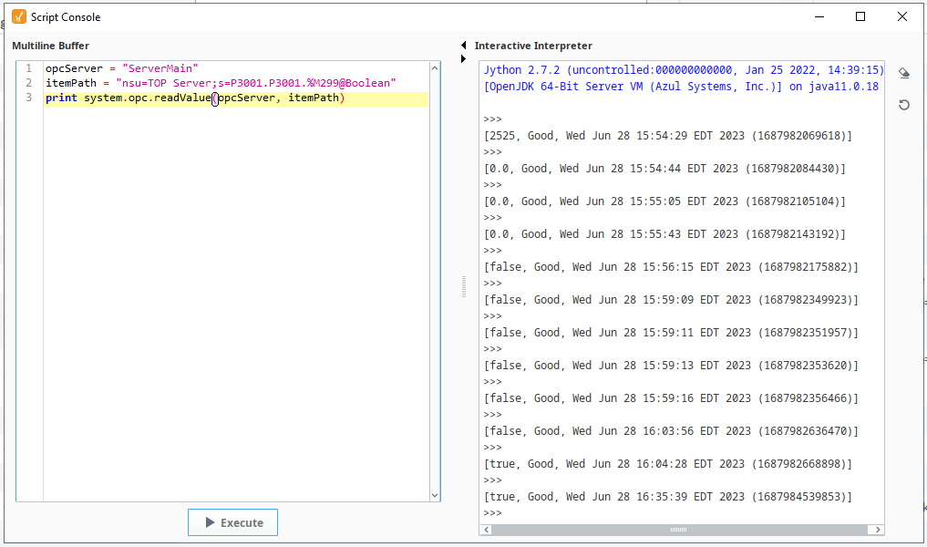

Hey Everyone,
I am bringing tags from my development to my production environment.
Here is an example of one of my OPC Item Paths for a tag:
> nsu=TOP Server;s=P3001.P3001.%M299@Boolean
The following error exists on the Tag Browser:
> [null, Error\_Configuration("Bad\_InternalError: An internal error occurred as a result of a programming or configuration error."), Wed Jun 28 16:11:37 EDT 2023 (1687983097029)]
I also see the following on the Logger:
> Failed to create item 'NodeId{ns=2, id=P3001.P3001.%M299@Boolean}': StatusCode{name=Bad\_InternalError, value=0x80020000, quality=bad}
Can someone help me understand what might be the root cause? All of the tags have this error coming from Top Server.

**Author:** ![brandon1](https://avatars.discourse-cdn.com/v4/letter/b/ea666f/32.png) [@brandon1](https://forum.inductiveautomation.com/u/brandon1)\
**Post date:** [June 28, 2023, 8:40pm UTC](https://forum.inductiveautomation.com/t/issue-with-opcua-address/75672/7 "2023-06-28T20:40:14Z")
Yes. I read the path using the scripting console.
 ![image](https://us1.discourse-cdn.com/inductiveautomation/original/3X/f/2/f2208dede0152c271835c1aae75c6314992e89ee.png)
**Post date:** [June 29, 2023, 11:49am UTC](https://forum.inductiveautomation.com/t/issue-with-opcua-address/75672/8 "2023-06-29T11:49:51Z")
I downgraded the Top Server version from 6.13 to 6.10 and it fixed the issue. Not sure why that made a difference. 🤷‍♂️
