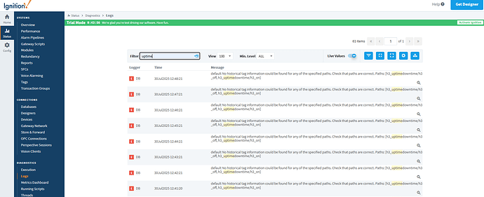

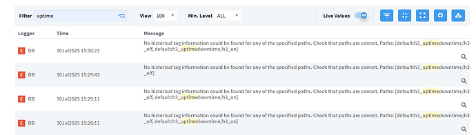

 ![image](https://us1.discourse-cdn.com/inductiveautomation/original/3X/1/b/1b1bf729d3362103fe62975b9e526c68c1a237e5.png)
 ![image](https://us1.discourse-cdn.com/inductiveautomation/original/3X/7/2/72e07dd50e8048891529455172287475ac611a60.png)
 ![image](https://us1.discourse-cdn.com/inductiveautomation/original/3X/7/8/7847ca10d8d56b5c18c3a858a61244521e77beee.png)
**Author:** ![BRYAN\_MOBLEY](https://avatars.discourse-cdn.com/v4/letter/b/db5fbb/32.png) [@BRYAN\_MOBLEY](https://forum.inductiveautomation.com/u/BRYAN_MOBLEY)\
**Post date:** [July 30, 2025, 9:29pm UTC](https://forum.inductiveautomation.com/t/issue-with-power-chart-ignition-perspective/109162/7 "2025-07-30T21:29:59Z")

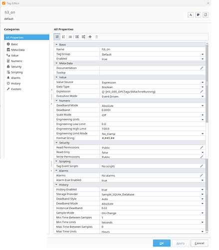

Can you post a pic of those tags history settings? That error in the log makes me think something is off there.
**Author:** ![anguyen09](https://avatars.discourse-cdn.com/v4/letter/a/d07c76/32.png) [@anguyen09](https://forum.inductiveautomation.com/u/anguyen09)\
**Post date:** [July 30, 2025, 10:02pm UTC](https://forum.inductiveautomation.com/t/issue-with-power-chart-ignition-perspective/109162/8 "2025-07-30T22:02:17Z")
![status_on](https://us1.discourse-cdn.com/inductiveautomation/original/3X/7/8/78dafd484cb383da8a9c877a01fa9e57bbf1bfc7.png)
 ![status_off](https://us1.discourse-cdn.com/inductiveautomation/original/3X/a/5/a5c6119d4e06df8d4e52065605bebd88a20bbddb.png)
 ![OPCtag and ExpressionTags](https://us1.discourse-cdn.com/inductiveautomation/original/3X/9/f/9fd5fab3ec7980f878c1b2dc39f466312dcec311.png)

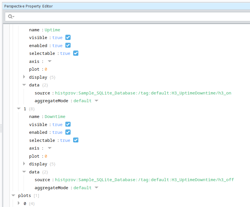

**Post date:** [July 31, 2025, 11:24am UTC](https://forum.inductiveautomation.com/t/issue-with-power-chart-ignition-perspective/109162/9 "2025-07-31T11:24:33Z")
Remove the {} brackets.
Try this path: histprov:Sample\_SQLite\_Database:/drv:Master\_SCADA:default:/tag:H3\_UptimeDowntime/h3\_off
**Post date:** [July 31, 2025, 3:31pm UTC](https://forum.inductiveautomation.com/t/issue-with-power-chart-ignition-perspective/109162/10 "2025-07-31T15:31:10Z")
![pic49](https://us1.discourse-cdn.com/inductiveautomation/original/3X/6/8/68fd4b5d5ec7b1037ea32e285993fdf66525d957.png)
 ![pic50](https://us1.discourse-cdn.com/inductiveautomation/original/3X/c/3/c34f4ec2460ef7260e50b6192c80710399ea5245.png)
there are some issues with the path
