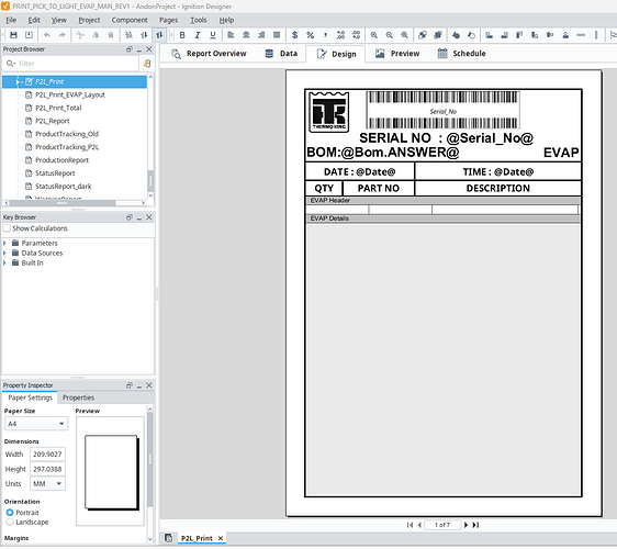

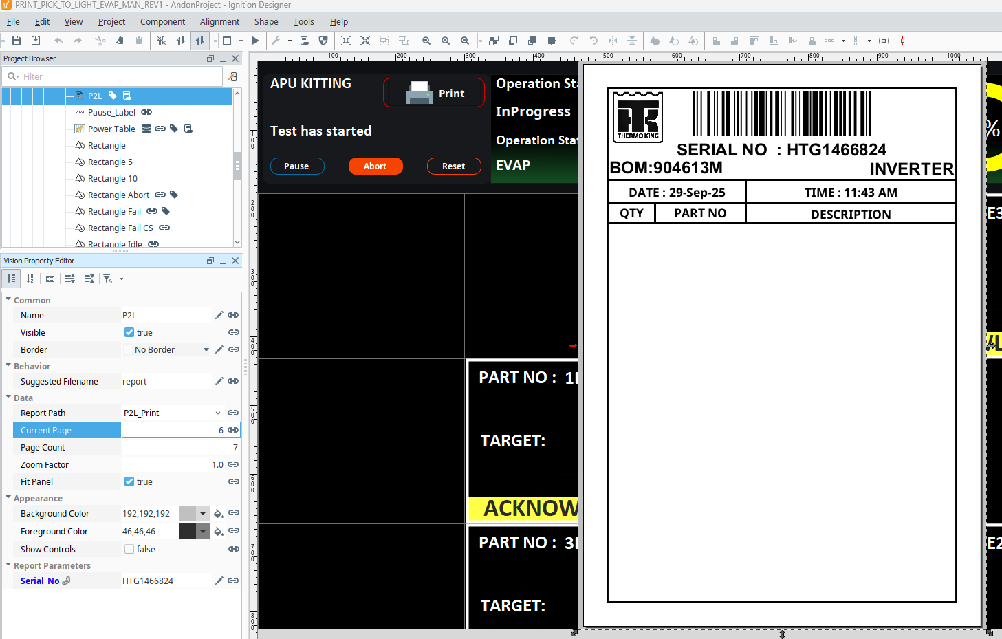

What i meant by invalid data is -
I have 7 different queries in report viewer for each page, for a given serial number there can be 1 or few pages applicable with data,( valid data) rest queries or pages will be empty.(inavlid data) , so i have written a query to see if the number of rows for each page is greater than 1( valid data ) , if yes then print only those pages and ignore others.

![image](https://us1.discourse-cdn.com/inductiveautomation/original/3X/2/4/247ed180cf7e7adbb9bafdce07d93b102644f1d2.png)
Invalid(or Not applicable) Data–
 ![image](https://us1.discourse-cdn.com/inductiveautomation/original/3X/3/5/356295312a42248d1b34589451d77e6a76e852d0.png)
Report –
 ![image](https://us1.discourse-cdn.com/inductiveautomation/original/3X/2/8/28dfd4cf4f25e40bb4b01725a21b920b5ccb319f.png)
 ![image](https://us1.discourse-cdn.com/inductiveautomation/original/3X/0/e/0e2513f9cca53655f4a1b50f8b010bbd9e07cfb7.png)

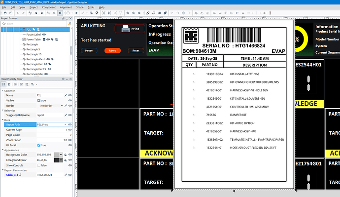

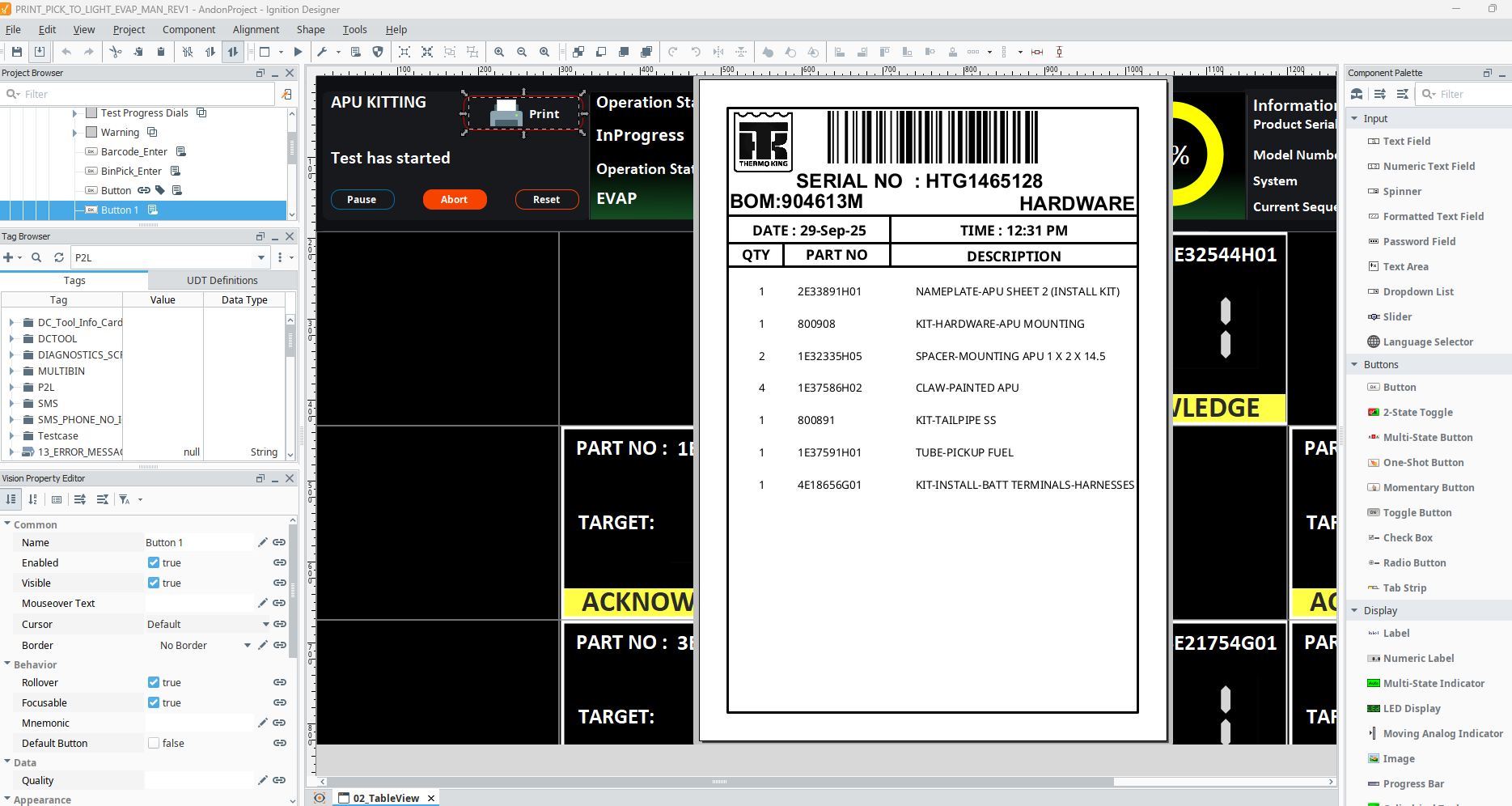

For now, i just want to print all pages irrespective of data in them, I have a script written ona mouse click button as mentioned above,
even in this case , the report viewer is empty in vision client, in same instance i have my designer open and i can see data in the designer.
Designer –
 ![image](https://us1.discourse-cdn.com/inductiveautomation/original/3X/0/1/015533416a24d70b33d62d425a61016f1879c9d3.png)
Vision Client -
 ![image](https://us1.discourse-cdn.com/inductiveautomation/original/3X/b/3/b30282320e3ccc78c6d72b9bf9a2b3fe0bf82043.png)
**Author:** ![sharan](https://avatars.discourse-cdn.com/v4/letter/s/258eb7/32.png) [@sharan](https://forum.inductiveautomation.com/u/sharan)\
**Post date:** [October 1, 2025, 5:29pm UTC](https://forum.inductiveautomation.com/t/issue-with-system-print-createprintjob/111056/10 "2025-10-01T17:29:48Z")
I put the report viewer in a popup window and opened the window when print is needed, this loaded the contents and i am able to print all the contents properly, Before this i was keeping the report viewer always, and printing from scripting,
