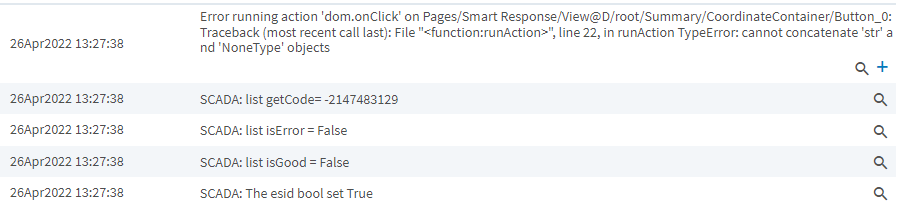

**Problem**
The tag doesn’t update…array elements remain False (watching them in the Designer tag browser)
**Code**
The code is in a button mouse onClick event.
```auto
logMsg = system.util.getLogger("SCADA")
esidTagPath = "[default]DataMap/esid"
esidQualityArray = system.tag.readBlocking([esidTagPath + "/igPwrBlkArrayQuality"])[0]
index = 0
for index in range (0,12):
	esidQualityArray.value[index] = True
	index = index + 1
try:
	list = system.tag.writeBlocking([esidTagPath + "/igPwrBlkArrayQaulity"], esidQualityArray)
	logMsg.debug("SCADA: The esid bool set True")
except:
	logMsg.debug("SCADA: exception")
logMsg.debug("SCADA: list isGood = " + str(list[0].isGood()))
logMsg.debug("SCADA: list isError = " + str(list[0].isError()))
logMsg.debug("SCADA: list getCode= " + str(list[0].getCode()))
logMsg.debug("SCADA: list getDiagnosticMessage= " + list[0].getDiagnosticMessage())
**Weirdness**
isGood() returns False
isError() returns False
getDiagnosticMessage() throws an exception
**Status Log**
 ![image](https://us1.discourse-cdn.com/inductiveautomation/original/3X/d/e/de5b650c2df5f886bda8972fa0e10ee42683279b.png)
Most likely something wrong with what I’m doing but I can’t find it. I’m doing similar things with Float arrays with no issues. Any suggestions?
Thank you.
**Post date:** [April 26, 2022, 6:35pm UTC](https://forum.inductiveautomation.com/t/issue-with-writeblocking-boolean-array/58891/2 "2022-04-26T18:35:52Z")
Typo in the tag path? ("Qaulity")

ARRRGGGHHHHH!!! #(_##111%%$_
Dang it.
@Kevin.Herron Thank you! I must’ve read that code 50 times. Embarrassing. Can I delete this post? 🙂
