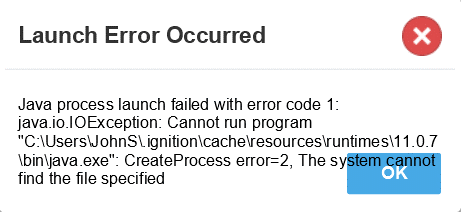

I am running Ignition 1.1.1 and I’m having an issue with one of my computers not being able to open the client or designer. I am getting this error message, but I do not know what other program would be using this executable. Has anyone experienced this, or know where I should look to fix this.
 ![asgfhytj](https://us1.discourse-cdn.com/inductiveautomation/original/3X/7/4/746aaa980fad4f520b9dbfb2918d3006dc16537a.png)

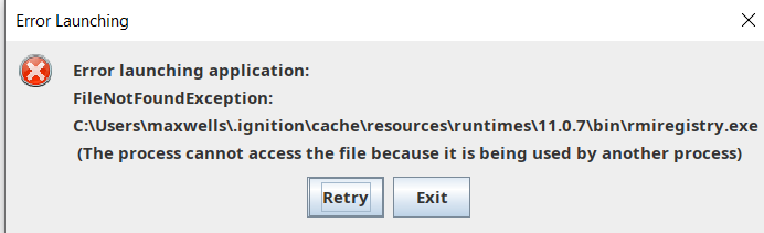

There is also another error that I have come across: ![ffythynndghgh](https://us1.discourse-cdn.com/inductiveautomation/original/3X/c/c/cc3d936b7f79b157c7dd1c7d8ed9e07383b77f7a.png)
**Post date:** [March 31, 2021, 4:27pm UTC](https://forum.inductiveautomation.com/t/issues-opening-client-or-designer/45075/3 "2021-03-31T16:27:10Z")
Try deleting that entire “11.0.7” folder and launching again.
**Author:** ![m.sanders](https://avatars.discourse-cdn.com/v4/letter/m/df705f/32.png) [@m.sanders](https://forum.inductiveautomation.com/u/m.sanders)\
**Post date:** [March 31, 2021, 4:55pm UTC](https://forum.inductiveautomation.com/t/issues-opening-client-or-designer/45075/4 "2021-03-31T16:55:04Z")
I gave that a shot, but once it gets back to the runtime step it will still give me the same error.
**Post date:** [March 31, 2021, 4:56pm UTC](https://forum.inductiveautomation.com/t/issues-opening-client-or-designer/45075/5 "2021-03-31T16:56:45Z")
Hmm. There might be some kind of AV software interfering then.
