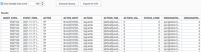

Hi.
The solution is partially working for me, the basic goes quite well.
SELECT \* FROM audit\_events - is returning the expected result, but when I try to do any filter, E.g.
SELECT \* FROM audit\_events WHERE ACTOR = “RCF” - it returns
an error saying that the column does not exist. I tried a few different options, but if I reference any column it returns the same error.
![image](https://us1.discourse-cdn.com/inductiveautomation/original/3X/9/f/9fef8ffda64bd05f1c46b38885b64dffd8211d52.png)
I also tried to do something similar with other tables, all work great, but it seems that the audit\_events table has something wrong in it and I can’t reference any column.
Any idea?

That said, I suspect the table has mixed or upper case names. PostgreSQL is case sensitive, and any unquoted identifiers are treated as lower case. (BTW, double quotes for identifiers, single quotes for values.)
**Post date:** [January 6, 2022, 4:55pm UTC](https://forum.inductiveautomation.com/t/issues-querying-audit-log/54734/3 "2022-01-06T16:55:47Z")
I believe auditing is the last Ignition table that’s generated uppercase, unfortunately. Which bears out Phil’s suggestion.

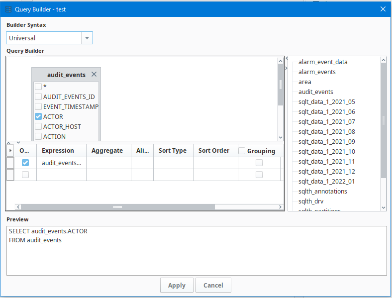

Hi. thank you for the tip about the new topic!
Unfortunately, I tried the single quote, double quote, lower case, upper case, lighting candles, and some garlic too 🙂
I tried using the Query Builder as well, it all works fantastic with all other tables, but I can’t make any reference to columns in the audit\_events table.
This is a very simple query, created by the Query Builder, it is returning the same error.
 ![image](https://us1.discourse-cdn.com/inductiveautomation/original/3X/5/a/5ad14e4e7bb2c6acdf9e698352d172265d111221.png)
![image](https://us1.discourse-cdn.com/inductiveautomation/original/3X/8/5/8540f019911b2f42e8ca22f32143e3b5fadbf9b2.png)

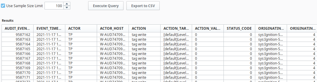

The simple SELECT \* FROM audit\_events works

The application is complex and there is some good level of SQL queries running alarm filters from multiple tables. This one was supposed to be the simplest query I have in the application.
Is there something wrong with the audit table?
I am using version 8.0.17 by the way.
Thank you very much!

Show your actual query.
