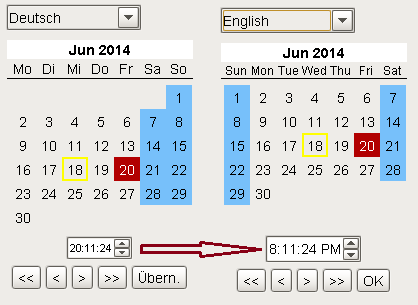

I did some test with the calendar components: The new translation system is really good, but there are still some little issues that should be fixed before release:
Calendar
- The use of the ‘Time Display Format’ is inconsistent.
When set to ‘12 hour’ the time field used 12 hour format, even if the client is startet with a language that does not use this format. After switching the language from ‘German’ to ‘English’ and back, the time is displayed in 24 hour format.
When set to ‘24 hour’, the display switches to 12 hour when language is switched to ‘English’.
- The time field uses a smaller font than configured until the language is switched for the first time.
 ![](https://us1.discourse-cdn.com/inductiveautomation/original/2X/c/c68732e3dded08375db3575388cc4089cdcc1469.png)

Thank you for giving us such detailed feed back. I’ve made bug tickets for these items, and most should be quick fixes.
