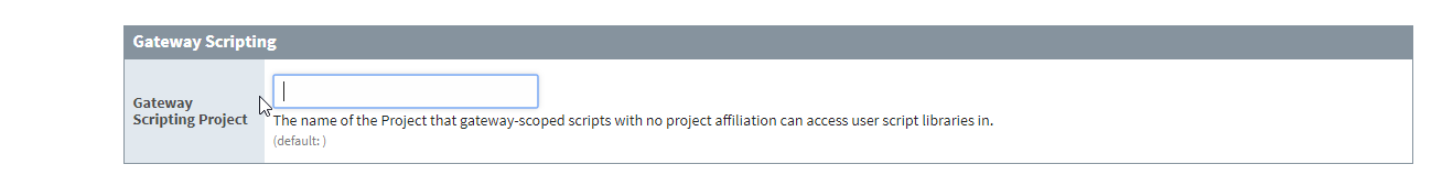

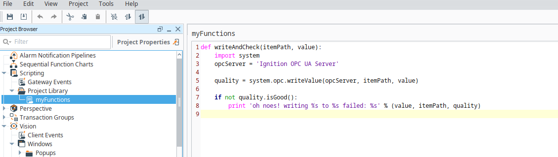

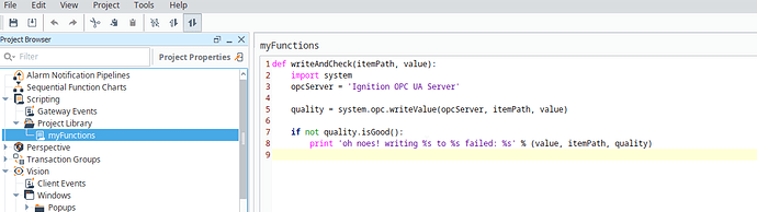

I’d like to use this simple function that @Kevin.Herron wrote above. Can I call it from a Gateway event/tag change script?
 ![image](https://us1.discourse-cdn.com/inductiveautomation/original/2X/b/bf2f97d9884d9fa1d499b52c21f8c20bcadcc45b.png) Is the project library the best place for it? Would I need to assign my project to the “Gateway Scripting Project” entry on the gateway? ![image](https://us1.discourse-cdn.com/inductiveautomation/original/2X/5/5d13a5102038902ef25ef6f1d253e75c22c0c707.png)
