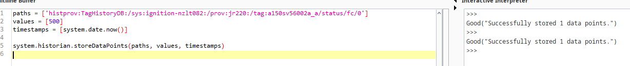

Could you share exactly what the script looked like when you had issues? I tried the syntax as it was originally and it worked for me, see attached picture. Note my gateway name and historian names are used in the function
 ![image](https://us1.discourse-cdn.com/inductiveautomation/original/3X/6/d/6d252025beb5c1aac063101dcf1cf3a40a477845.png)

Thank you for answering the question @qpadgham , I think I might have misspelled something in the paths, following your instruction, i was able to make it work:
 ![image](https://us1.discourse-cdn.com/inductiveautomation/original/3X/8/2/82ceb8c1fac848afac6d3a6aae4fbb02ea77b9a7.png)
