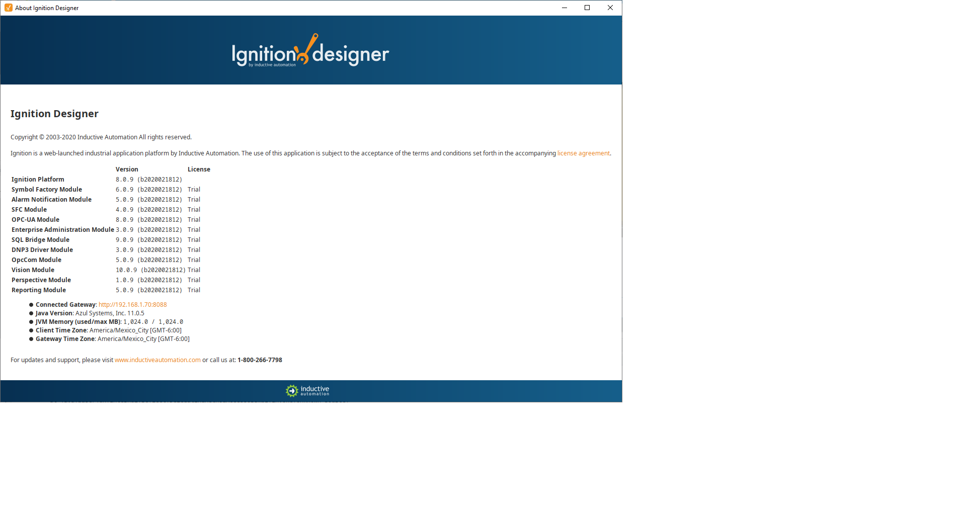

Additional information showing the designer “About” page, designer performance, gateway performace (not an issue), and project properties:
 ![Desinger About Page](https://us1.discourse-cdn.com/inductiveautomation/original/2X/2/25a8a4c008d236da9afa66e936be14e22c2c97d1.png)
 ![GatewayPerformance](https://us1.discourse-cdn.com/inductiveautomation/original/2X/1/1beef82dc1b7567b69b985b3a69977dd127a1df9.png)
 ![Performance](https://us1.discourse-cdn.com/inductiveautomation/original/2X/a/a6e73096f1000b3fc0d9e11e504596bca72cee10.png)
 ![ProjectProperties](https://us1.discourse-cdn.com/inductiveautomation/original/2X/3/3a8eca20f9f1284571b970605dfd40c553e36fe3.png)
Finally, my development machine has 64bit architecture with more than 32GB of RAM.
What, if any solutions are available for this issue?
