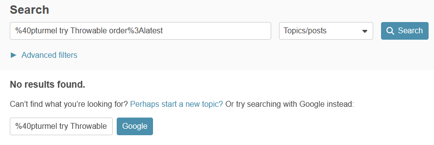

~~This link doesn't seem to behave as intended, I end up with this as a result:~~
> **Search result**
> ![image](https://us1.discourse-cdn.com/inductiveautomation/original/3X/f/5/f5e77287dcd39f856db1911250d3dd0bf1db7d9e.png)
~~Looks like it's HTML encoding the symbols that are used to denote advanced filter items.~~
manually changing the search to `try . . . throwable` seems to work though.
**Post date:** [December 11, 2025, 5:00pm UTC](https://forum.inductiveautomation.com/t/java-lang-illegalstateexception-session-is-not-running/112763/4 "2025-12-11T17:00:05Z")
> [@ryan.white](#):
Fixed.
