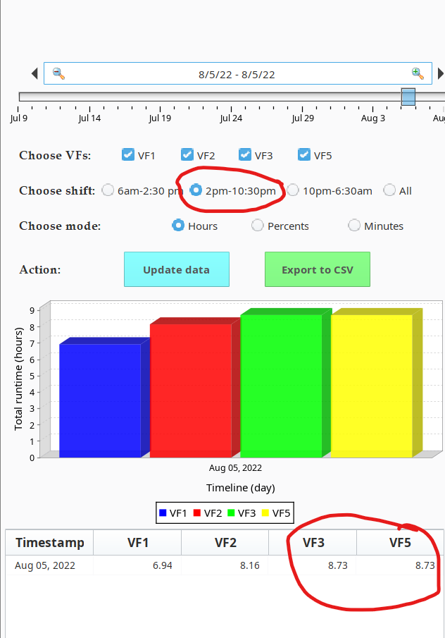

Hello, I am having trouble using the system.tag.queryTagHistory() function, specifically the ‘interval’ argument and the startDate and endDate arguments.
I have a script that looks at multiple tags that correspond to the runtime of some machines. The tags are true when the machine is powered on, and false when they are off. I am using system.tag.queryTagHistory() to tell me how long each machine is powered on over the course of multiple shifts in the day.

dsDuration = system.tag.queryTagHistory(paths=paths, startDate = startTime, endDate = endTime, intervalHours = interval, aggregationMode="DurationOn", returnFormat="Wide")
dsPercent = system.tag.queryTagHistory(paths=paths, startDate = startTime, endDate = endTime, intervalHours = interval, aggregationMode="Average", returnFormat="Wide")
Currently the interval time is set to 8.5 hours, because that is how long each shift is, and the start and endDate arguments are set to the start and end times of the shift. However, the function is returning runtimes that are sometimes longer than 8.5 hours, which does not make sense.
Example of what i mean:
 ![image](https://us1.discourse-cdn.com/inductiveautomation/original/3X/7/5/75bc969a82e1b7f6e2206799f8c01c8ea9d3b576.png)

**Post date:** [August 8, 2022, 2:37pm UTC](https://forum.inductiveautomation.com/t/jython-troubelshooting-problem-with-script-that-retrieves-how-long-a-boolean-value-is-true/62772/2 "2022-08-08T14:37:19Z")
You’re script is very difficult to read. Please edit your post and use the preformatted text option `</>` to post your script. This will maintain indentation and formatting which will make it much easier for us to read and help.
Most likely what is happening is that the function is including the bounding values. Since you have not included the flag for `includeBoundingValues` in the function call. The default value of this flag is dependent on the query mode.
[https://docs.inductiveautomation.com/display/DOC81/system.tag.queryTagHistory](https://docs.inductiveautomation.com/display/DOC81/system.tag.queryTagHistory)
You might want to consider using `system.tag.queryTagCalculations()`. It may be a beter fit for your application (from what I can tell).
[https://docs.inductiveautomation.com/display/DOC81/system.tag.queryTagCalculations](https://docs.inductiveautomation.com/display/DOC81/system.tag.queryTagCalculations)
**Author:** ![Royal\_Rowland](https://avatars.discourse-cdn.com/v4/letter/r/e19b73/32.png) [@Royal\_Rowland](https://forum.inductiveautomation.com/u/Royal_Rowland)\
**Post date:** [August 10, 2022, 3:35pm UTC](https://forum.inductiveautomation.com/t/jython-troubelshooting-problem-with-script-that-retrieves-how-long-a-boolean-value-is-true/62772/3 "2022-08-10T15:35:52Z")
Thank you for the suggestion. I have set includeBoundingValues to False and that seems to have fixed the problem. Much appreciated!

**Post date:** [August 10, 2022, 5:35pm UTC](https://forum.inductiveautomation.com/t/jython-troubelshooting-problem-with-script-that-retrieves-how-long-a-boolean-value-is-true/62772/4 "2022-08-10T17:35:49Z")
> [@Royal\_Rowland](#):
> According to the documentation, Aggregation Mode is not a parameter for this function. Although my original problem is solved, i am now curious about this one.
That's correct.
With `system.tag.queryTagCalculations` you provide a list of `calculations` (aggregation functions). The returned dataset will have a column for each requested calculation. In this way you can perform multiple aggregations on multiple tags. The number of rows will be equal to the number of tags sent to the function.
For instance, you are calling `system.tag.queryTagHistory()` twice. Once to get the DurationOn aggregate and once to get the Average aggregate.
You could accomplish the same with a single call to `system.tag.queryTagCalculations()`. Something like
```auto
system.tag.queryTagCalculations(paths,['DurationOn','Average'],startTime,endTime,includeBoundingValues = False)
