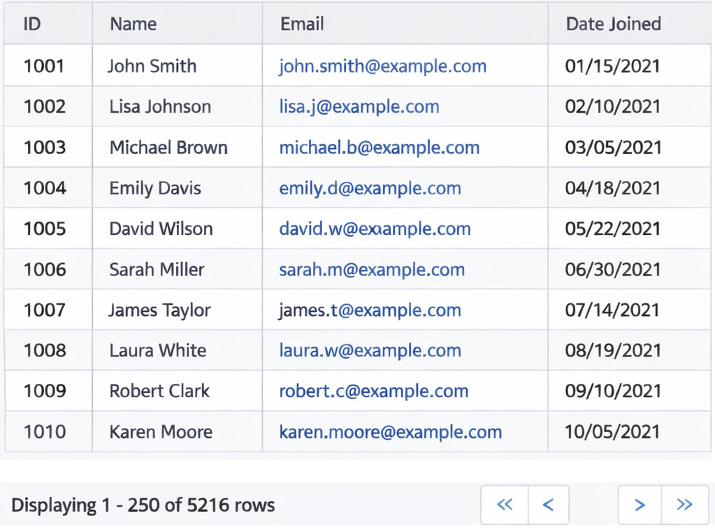

How many rows are being returned? In my testing, the column widths didn't start goofing up until the return sizes became excessively large. I was able to address the issue by limiting the return size to 250 rows. If more than that are needed, simply add some nav buttons and a display label, so the user can iterate through all of the results with only 250 rows or less at a time. You'll have to add a custom property to store the current `OFFSET`, and then simply manipulate it using the buttons.
**Example:**
```python
# actionPerformed event handler
# > button
table = event.source.parent('Power Table')
currentOffset = table.offset
# Prevent the new offset from exceeding the last set of numbers
newOffset = min(currentOffset + 250, table.maxReturnSize - table.maxReturnSize % 250)
table.offset = newOffset
 ![image](https://us1.discourse-cdn.com/inductiveautomation/original/3X/6/f/6ffe308c2971037e112eee19d4002d8639aaa7cf.jpeg)

10K rows returned without columns size issue when switching to power table screen, but if input anything in text field trying to filter ,it happens. Tried your way and it worked , wanted to see if there is a solution for large table.Thank you .
