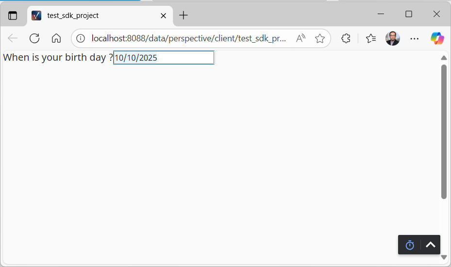

I don’t have any problem during the compilation but when i run this thing, it loose its popup calendar. But still can type something on it.
 ![image](https://us1.discourse-cdn.com/inductiveautomation/original/3X/d/4/d468aaae93d90a23da2add30c8f41075d7f29dbb.png)
If i look at the KendoUI website, the calendar icon is shown on the right side and popup calendar appears as the user click on that icon.

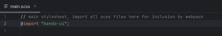

Are there any CCS resources that need to be imported?
**Author:** ![Gunawan\_Hadikusumo](https://avatars.discourse-cdn.com/v4/letter/g/c57346/32.png) [@Gunawan\_Hadikusumo](https://forum.inductiveautomation.com/u/Gunawan_Hadikusumo)\
**Post date:** [October 15, 2025, 9:45pm UTC](https://forum.inductiveautomation.com/t/kendoui-react-datepicker-input-doesnt-behave-correctly-on-ignition-custom-module/111331/5 "2025-10-15T21:45:44Z")

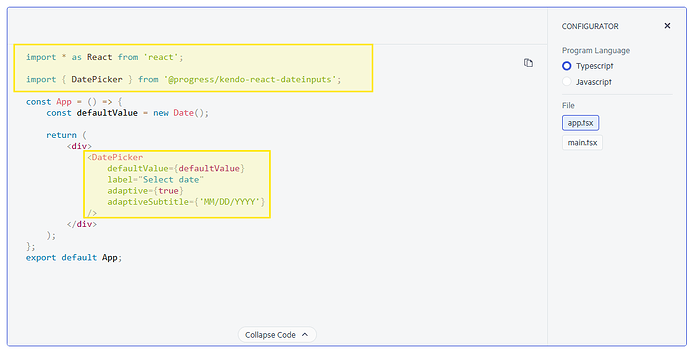

Thank you for replying. But i don’t think i need to add any extra css to be imported. If you see the sample code from KendoUI link below.
[https://www.telerik.com/kendo-react-ui/components/dateinputs/datepicker/adaptive-rendering](https://www.telerik.com/kendo-react-ui/components/dateinputs/datepicker/adaptive-rendering)
 ![image](https://us1.discourse-cdn.com/inductiveautomation/original/3X/5/f/5f88b0a6b8f7b6a5e8e68a971d5e4cc658786ede.png)
I believe by default when we use kendo-ui components its automatically provides everything we need.

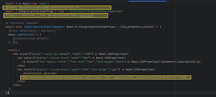

**Post date:** [October 19, 2025, 11:29pm UTC](https://forum.inductiveautomation.com/t/kendoui-react-datepicker-input-doesnt-behave-correctly-on-ignition-custom-module/111331/7 "2025-10-19T23:29:52Z")
Thanks for responding and sorry for the delay from my side due a lot of other work to be done.
Basically i had done what you suggested based on the telerik website to download the necessary css. But still got an issue.
If you look at the following code below, i had imported everything from telerik (the css and dateinput components).
 ![image](https://us1.discourse-cdn.com/inductiveautomation/original/3X/b/b/bb28e962ab554a740c28836924582c23eb4361ae.png)
**ISingleInputCalendar.tsx**
```typescript
import * as React from 'react';
import '@progress/kendo-theme-default/dist/all.css';
import { ISingleInputCalendarProps } from '../interfaces/ISingleInputCalendarProps'
import { DatePicker } from '@progress/kendo-react-dateinputs';
// Functional Component
export const SingleInputCalendarComponent: React.FC<ISingleInputCalendarProps> = ({id,parameters,values}) => {
  const defaultValue = new Date();
  React.useEffect(() => {
  return (
     <div style={{"border":"solid 2px #a9a9a9","width":"100%"} as React.CSSProperties}>
        <div style={{"display":"inline-block","width":"80%"} as React.CSSProperties}>
            <p style={{"font-family":"arial","font-size":"12pt","font-weight":"bold"} as React.CSSProperties}>{parameters.description}</p>
        <div style={{"display":"inline-block","width":"20%","text-align":"right"} as React.CSSProperties}>
            {/*}<h1>DatePicker Here</h1>*/}
            <DatePicker defaultValue={defaultValue} label="Select date" adaptive={true} adaptiveSubtitle={'MM/DD/YYYY'}/>

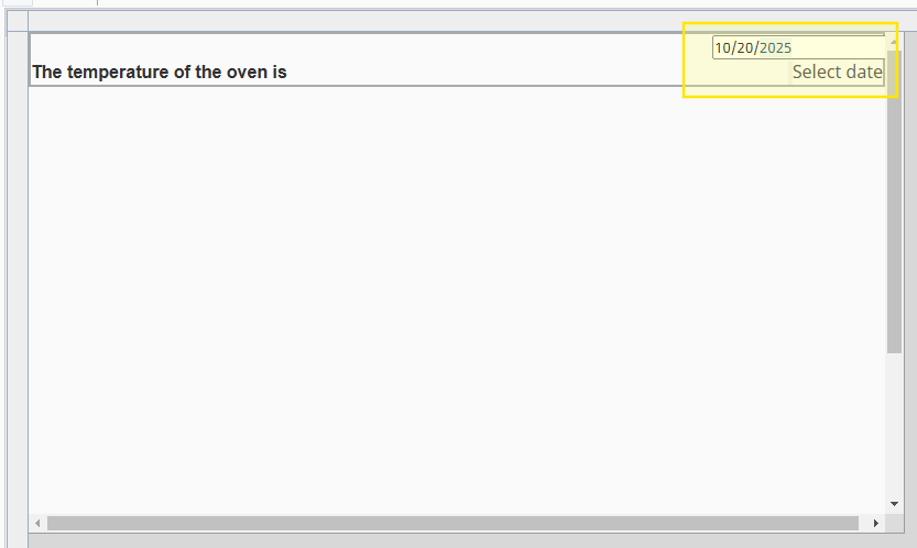

The compilation ran perfectly without any error at all. Then i went to Ignition designer , trying to drag my custom component on the container but then i got the error as seen below:
 ![image](https://us1.discourse-cdn.com/inductiveautomation/original/3X/1/4/14932ba5f60d198dd520cacb256a991730e221dd.png)

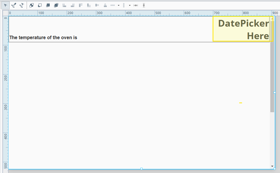

To identify what actually triggered the issues, i commented all KendoUI references and on rendering i also commented the KendoUI DatePicker component declaration. I just replaced it with simple working “DATE PICKER HERE”.
 ![image](https://us1.discourse-cdn.com/inductiveautomation/original/3X/9/0/9094a17bc960481e1a911a17f12fdcd307340954.png)
And i went to the designer again, try to drag my custom component to my container….it worked … no errors.
 ![image](https://us1.discourse-cdn.com/inductiveautomation/original/3X/1/e/1e6922c22a653b6231c75eb121313109096a4111.png)
Has anyone ever tried to integrate KendoUI React component inside Ignition Scada Custom module for perspective before ?
**Post date:** [October 20, 2025, 1:59am UTC](https://forum.inductiveautomation.com/t/kendoui-react-datepicker-input-doesnt-behave-correctly-on-ignition-custom-module/111331/12 "2025-10-20T01:59:55Z")
If i commented the css reference (line 2, highlighted)
 ![image](https://us1.discourse-cdn.com/inductiveautomation/original/3X/9/e/9ec5c5dab18cfd2c52810adb24cbb461f584c866.png)
The date picker appears but not reacting. The **select date** is supposed to be an calendar icon.
 ![image](https://us1.discourse-cdn.com/inductiveautomation/original/3X/e/a/ea9ac530150fb323578992138b810355fc9224da.png)

It turned out that i had to update the tslib to the latest. Then copy the stylesheet into from kendoui **all.css** into ignition resource web client **main.scss**.
 ![image](https://us1.discourse-cdn.com/inductiveautomation/original/3X/9/d/9d375a6586cebcb4ea4c38d743c7b42151e539d9.png)
So basically i created kendo-ui.scss on the web package client section, copy the content of all.css and paste onto it. Then i modified **main.scss** to import that new scss file.
