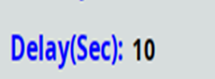

Hello,
I am experiencing an issue with the built-in Ignition function:
`system.gui.confirm(confirmationText, "Confirm Action")`.
When the confirmation popup appears, mouse interactions work correctly:
- Clicking **Yes** performs the Yes action
- Clicking **No** performs the No action
However, the issue occurs when using the **keyboard**.
### Steps to reproduce:
1. Change a value (for example, from **10** to **11** ).
2. The confirmation popup appears (see Fig. 1 , Fig. 2 , Fig. 3).
3. Press **Tab** → focus moves to **Yes**.
4. Press **Tab** again → focus moves to **No**.
5. Press **Enter** while **No** is focused.
### Actual Behavior:
Even when **No** is focused, pressing **Enter** still performs the **Yes** action, and the value changes to **11**.
### Expected Behavior:
Pressing **Enter** should trigger the button that currently has focus.
If **No** is focused, the No action should run.
This makes keyboard navigation behave incorrectly and may cause unintended changes.
Please let me know if this is a known issue or if there is a recommended workaround.
Thank you.
Fig1: The value is 10
 ![image](https://us1.discourse-cdn.com/inductiveautomation/original/3X/b/8/b80818c7deb57b14d67884fe35f504df630b5306.png)
Fig2: The confirmation Popup appears(Changing Value from 10 to 11)
 ![image](https://us1.discourse-cdn.com/inductiveautomation/original/3X/e/c/ec08cb1e560dad9b7d7ec3da7465bd167c1d660e.png)
Fig3: Even when the focus is on **No** , when I press **Enter** , the value **11** is still updated.
 ![image](https://us1.discourse-cdn.com/inductiveautomation/original/3X/2/7/27b1dc80afeb673f756156149118ebede424ca26.png)

Wrap your system.gui.confirm() call like this:
```python
from javax.swing import UIManager
UIManager.put("Button.defaultButtonFollowsFocus", True)
x = system.gui.confirm('Really?', 'Title')
UIManager.put("Button.defaultButtonFollowsFocus", False)
This will make the default button follow the focus.
