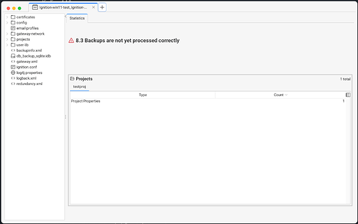

**Post date:** [August 12, 2025, 5:30pm UTC](https://forum.inductiveautomation.com/t/kindling-a-collection-of-tools-to-help-with-ignition/54689/92 "2025-08-12T17:30:39Z")
Kindling 1.4.0 has been released 🥳
Highlight features include translation bundle editing:
 ![image](https://us1.discourse-cdn.com/inductiveautomation/original/3X/e/6/e6ffdcadf54caa9aca11a98f57926ed7f99b86d2.png)
You can import a translation export from Ignition, then either edit it inline in Kindling or (more likely) copy it out to Excel via the Copy TSV button in the bottom right corner. Make your changes, paste the bundle back in, then re-export into Ignition's proprietary format. Not the smoothest workflow, but better than nothing until 8.3 😃
And thanks to the incredible reverse engineering work of the support apps team, _IDB tag viewing and export_:
 ![image](https://us1.discourse-cdn.com/inductiveautomation/original/3X/0/9/093094525d4945dc65c3e2b34bd0dac9917f1c99.png)
For developers (including module authors) dealing with 8.3's new restrictions on Java serialization, there's a new java serialization viewer tool that simply loads raw binary from files and attempts to parse it and explain what it contains:
 ![image](https://us1.discourse-cdn.com/inductiveautomation/original/3X/c/6/c69b9656c998162822ee464e988f2b1297b4ac3b.jpeg)
As a temporary measure until the next release with fully reworked .gwbk parsing, detected 8.3 gateway backups will throw up a warning in Kindling, though basic archive related functionality will still work:
 ![image](https://us1.discourse-cdn.com/inductiveautomation/original/3X/6/c/6c5380c50bf1285481c5d0cc03382309f9088da5.png)
Thanks again to new/existing contributors including @Spencer_Lommel1 and @Eric_Byrd for their work on this release! (And @kcollins and @jcoffman for their help on the release pipeline!)

**Post date:** [August 12, 2025, 5:33pm UTC](https://forum.inductiveautomation.com/t/kindling-a-collection-of-tools-to-help-with-ignition/54689/93 "2025-08-12T17:33:44Z")
Anyone interested in 8.3 compatibility should keep an eye on this issue:
> <https://github.com/inductiveautomation/kindling/issues/295>
> \### Update gateway backup parsing
> 1. Show config information over IDB informatio…n
> 2. Show migration status of tables?
> 3. Something something partial backups?
> 4. Migrate/duplicate tag config view
> 5. Note: Since systemProps is not guaranteed to exist, currently all meta prop lookup fails for a brand new .gwbk from 8.3
