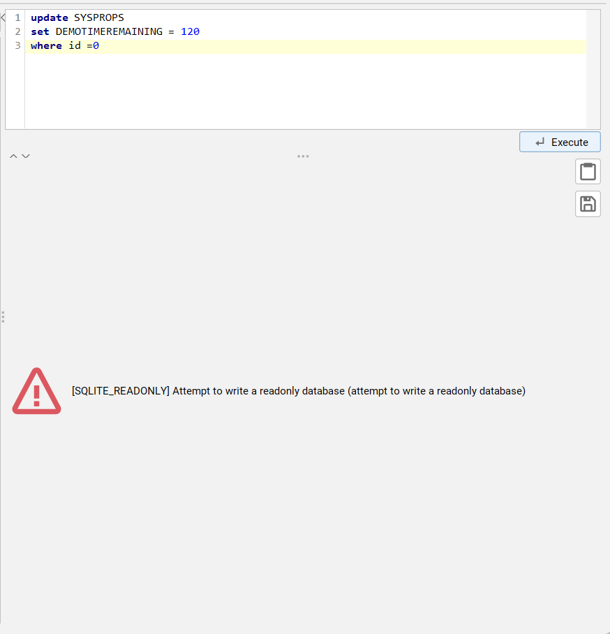

I am trying to edit the DEMOTIMEREMAINING for module debugging from Kindling, but I get an error message that the database is readonly. Am I forced to open the IDB file in another program?
**Post date:** [October 1, 2025, 4:45pm UTC](https://forum.inductiveautomation.com/t/kindling-a-collection-of-tools-to-help-with-ignition/54689/110 "2025-10-01T16:45:08Z")
sqlite databases can't be written to from multiple processes. You'll have to stop the Ignition Gateway before you can write to it, from any other software.
**Author:** ![Porter\_Ellis](https://avatars.discourse-cdn.com/v4/letter/p/ed8c4c/32.png) [@Porter\_Ellis](https://forum.inductiveautomation.com/u/Porter_Ellis)\
**Post date:** [October 1, 2025, 4:52pm UTC](https://forum.inductiveautomation.com/t/kindling-a-collection-of-tools-to-help-with-ignition/54689/111 "2025-10-01T16:52:42Z")
This is the error I am getting even when the Ignition service is stopped and Kindling is opened with Admin privileges:
 ![image](https://us1.discourse-cdn.com/inductiveautomation/original/3X/9/0/902dd4f151583316ca82e3bdc276a89ae404fe0d.png)
**Post date:** [October 1, 2025, 4:58pm UTC](https://forum.inductiveautomation.com/t/kindling-a-collection-of-tools-to-help-with-ignition/54689/112 "2025-10-01T16:58:59Z")
Hmm, looks like Kindling might be opening it in read only mode. Don't know if that's configurable or not.
**Post date:** [October 1, 2025, 5:04pm UTC](https://forum.inductiveautomation.com/t/kindling-a-collection-of-tools-to-help-with-ignition/54689/113 "2025-10-01T17:04:38Z")
The ‘db’ folder that contains the .idb file is set to read-only and won’t allow me to enable writing. Could that be the issue?
**Post date:** [October 1, 2025, 5:59pm UTC](https://forum.inductiveautomation.com/t/kindling-a-collection-of-tools-to-help-with-ignition/54689/114 "2025-10-01T17:59:18Z")
Kindling is strictly read-only for all IDB connections, there's no support for writing data back.
**Post date:** [October 1, 2025, 6:05pm UTC](https://forum.inductiveautomation.com/t/kindling-a-collection-of-tools-to-help-with-ignition/54689/115 "2025-10-01T18:05:13Z")
Understood. I figured out how to write a new time to the config.idb, but when it expires the gateway atuomatically resets it to 2 hours. Is there another setting that controls what the timer resets to? I would like to reset the timer to 120 seconds automatically.
**Post date:** [October 1, 2025, 6:18pm UTC](https://forum.inductiveautomation.com/t/kindling-a-collection-of-tools-to-help-with-ignition/54689/116 "2025-10-01T18:18:05Z")
No, because if there were such a setting somebody could change it to int/long max and have an effectively infinite trial.
