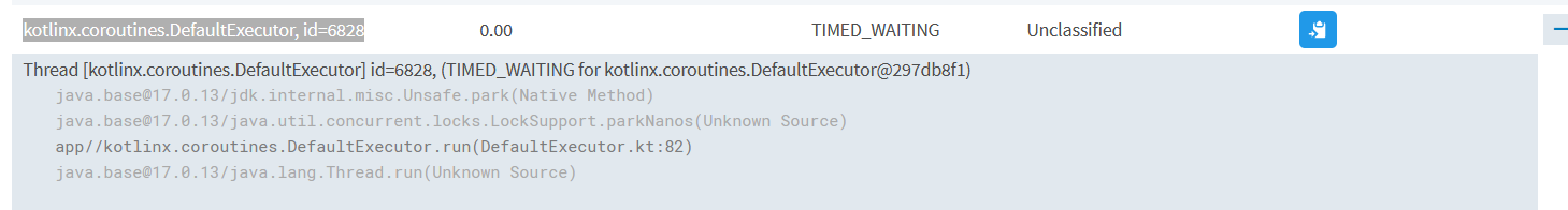

Is anyone using [coroutines and SharedFlow](https://kotlinlang.org/api/kotlinx.coroutines/kotlinx-coroutines-core/kotlinx.coroutines.flow/-shared-flow/)?
Or will we better off sticking with [execution managers](https://www.sdk-docs.inductiveautomation.com/docs/programming-for-the-gateway/working-with-platform-services/#creating-private-execution-managers)?
 ![image](https://us1.discourse-cdn.com/inductiveautomation/original/3X/b/5/b57b8dc7ac27ee7535c59f701532edb6f1274804.png)
Any tips or examples for a module that needs to await tcp messages and _do something_™ when there is new data?
