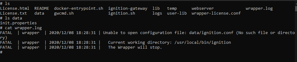

I was trying to see how Ignition is in the Kubernetes world. I’m simply just trying to backup the path `/usr/local/bin/ignition/data`. But I can not get it to work. If I remove the mount path the container will at least run. If I leave it as is the pod runs but Ignition never starts up. Wondering if there’s a command that needs to be run or something?

LOGS
```auto
Creating init.properties file
Creating gateway.xml
cp: cannot stat 'data/gateway.xml_clean': No such file or directory
Adding gateway.publicAddress.autoDetect=false to gateway.xml
failed to load external entity "data/gateway.xml"
Adding gateway.publicAddress.address=0.0.0.0 to gateway.xml
Adding gateway.publicAddress.httpPort=8088 to gateway.xml
Adding gateway.publicAddress.httpsPort=8043 to gateway.xml
Enabling arg pass through
Disabling PID file check
Starting Ignition gateway
Following wrapper.log
On container (nothing in the data folder really)
 ![image](https://us1.discourse-cdn.com/inductiveautomation/original/3X/b/6/b643b31da76859b748b88ef8dc12449e10a9cf12.png)
**Author:** ![kcollins](https://sea1.discourse-cdn.com/inductiveautomation/user_avatar/forum.inductiveautomation.com/kcollins/32/19646_2.png) [@kcollins](https://forum.inductiveautomation.com/u/kcollins)\
**Post date:** [December 8, 2020, 6:55pm UTC](https://forum.inductiveautomation.com/t/kubernetes-persistentvolume-backup-data/41306/2 "2020-12-08T18:55:37Z")
Right now I think this will likely not work [on the official image at this time], for some of the reasons I describe in my unofficial image docs at [ALTERNATIVE: How to persist Gateway data](https://github.com/thirdgen88/ignition-docker/tree/master/docs#alternative-how-to-persist-gateway-data). You might have a go at subbing for `kcollins/ignition:8.1` and pointing your volume target at `/data`. Let me know if that works out for ya…

**Author:** ![hodgins.e](https://avatars.discourse-cdn.com/v4/letter/h/977dab/32.png) [@hodgins.e](https://forum.inductiveautomation.com/u/hodgins.e)\
**Post date:** [December 8, 2020, 9:09pm UTC](https://forum.inductiveautomation.com/t/kubernetes-persistentvolume-backup-data/41306/4 "2020-12-08T21:09:42Z")
well that’s awesome, that did work out for me. Had some issues initially but once I restarted my local environment it worked. Thanks @kcollins !
