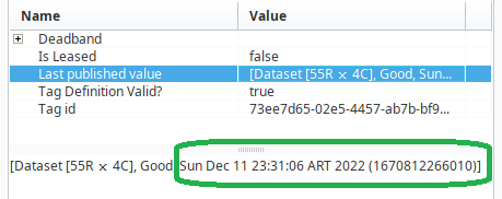

Hi folks, good morning. How can I access this info through scripting?
![image](https://us1.discourse-cdn.com/inductiveautomation/original/3X/6/b/6b0ec1c348b2809b8ed043ef907635589e13cbc6.png)
Tried tag.timestamp(), but that basically returns a timestamp very close to the current moment, not the last time the -memory- tag was updated.
Thanks!
**Post date:** [December 12, 2022, 2:42pm UTC](https://forum.inductiveautomation.com/t/last-published-value/67501/2 "2022-12-12T14:42:53Z")
When you read a tag's value from scripting, you get a `QualifiedValue` that includes `.value`, `.quality`, and `.timestamp`.

Thanks Phil...newbie mistake; was on the right path and got it working now. Regards.
