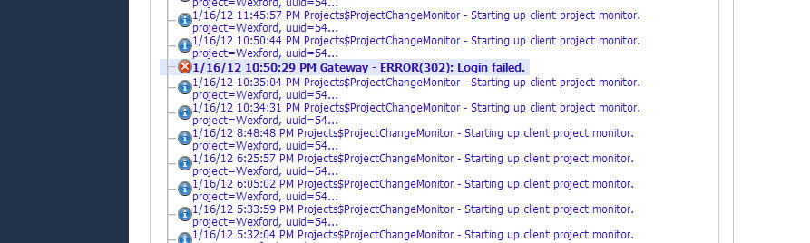

Yes when i log into the gateway and go to Console, i see errors reported around the same time? Please refer to attached screen grabs. But when i restart the server i was able to launch the project once but then i was unable to launch it again after that.

**Author:** ![peadair](https://avatars.discourse-cdn.com/v4/letter/p/da6949/32.png) [@peadair](https://forum.inductiveautomation.com/u/peadair)\
**Post date:** [January 17, 2012, 3:46pm UTC](https://forum.inductiveautomation.com/t/launching-a-project/3865/4 "2012-01-17T15:46:55Z")
I am now also not able to launch the project viewer either and this error is now appearing when trying to launch it.

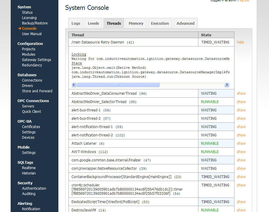

It sounds like you’re running into a deadlock in the gateway. To confirm this, log into the gateway, and go to Console\>Threads. It will tell you at the top if there is a deadlock detected- if so, export the thread dump (via the button at the bottom), and upload it here.
I highly suspect that the problem has been fixed, and that upgrading to at least 7.2.10 (the last in the 7.2 line, available from the “archived downloads” section) should fix it. If you post the thread dump, however, I can try to confirm this.

Please find attached the thread dump.

**Author:** ![Carl.Gould](https://sea1.discourse-cdn.com/inductiveautomation/user_avatar/forum.inductiveautomation.com/carl.gould/32/7262_2.png) [@Carl.Gould](https://forum.inductiveautomation.com/u/Carl.Gould)\
**Post date:** [January 17, 2012, 5:54pm UTC](https://forum.inductiveautomation.com/t/launching-a-project/3865/7 "2012-01-17T17:54:54Z")
That stack trace doesn’t show that there is a deadlock - it looks fine.
The first message you posted is quite strange - for some reason, a response from the gateway is getting cut short. What’s the network look like between the computer you’re trying to launch on, and the Ignition Gateway? Does this problem occur on any client machine? What if you go to the actual server that the Gateway is running on: does it happen then?
At this point, I’m suspecting networking issues. Also, 7.2.5 is old. Try upgrading to the latest 7.2 version.

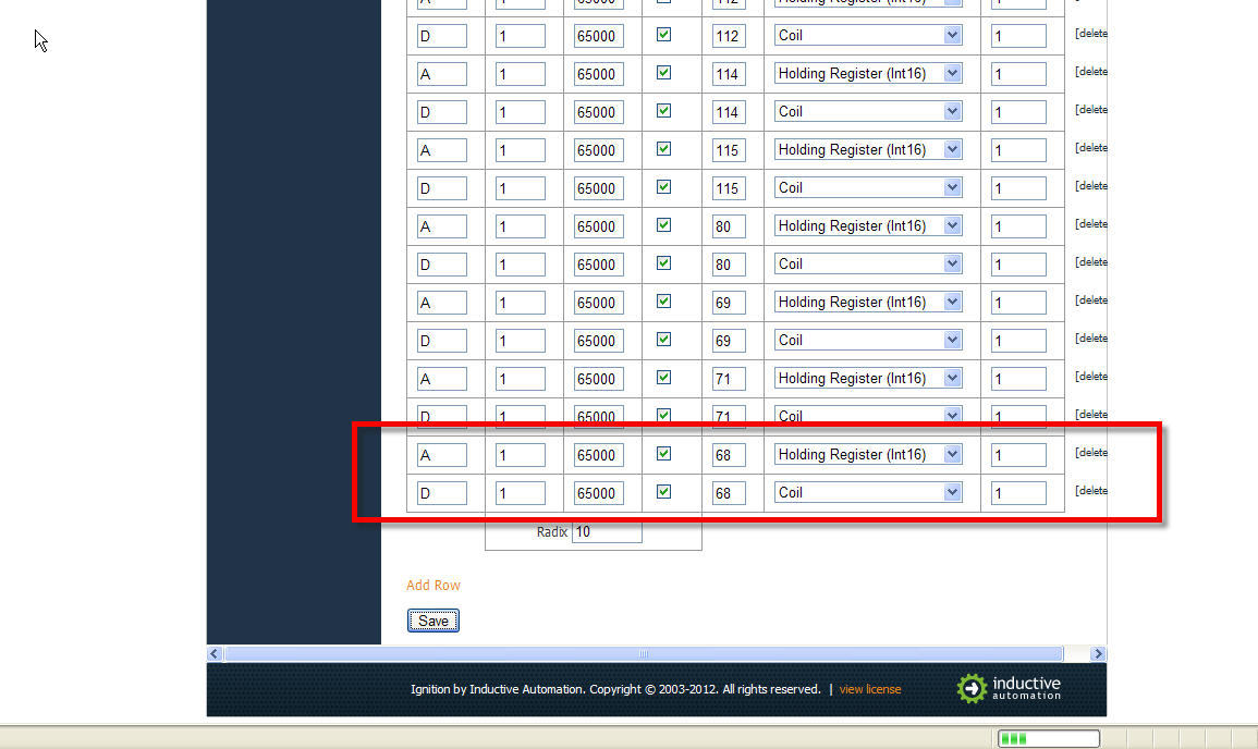

**Post date:** [January 24, 2012, 3:52pm UTC](https://forum.inductiveautomation.com/t/launching-a-project/3865/14 "2012-01-24T15:52:40Z")
Hi Carl and Colby,
Thanks for the time you spent on this, yes our servers upload capacity is severely limited but is something we are currently in the process of sorting. In relation to the reporting project, that is rarely opened so would not be as much of a problem.
We have come across another problem when trying to add a device to the OPC-UA (see attached screen grab). It is allowing me to add the row i wish but when i try to save them the progress bar gets to about half way and then freezes. I then close out of the configuration page and then I get a gateway connection error (see attached screen grab).
Would it be possible for you to log onto the project again with the username and password that i emailed to Carl the other day and see if you can see what could be causing this problem. Please note that each device has about 130,000 addresses, could this be the problem and if so we will be able to reduce those numbers.
 ![](https://us1.discourse-cdn.com/inductiveautomation/original/1X/93e47d3ad655ac55ffdb7ca81a84926534b34ed8.jpg)
 ![](https://us1.discourse-cdn.com/inductiveautomation/original/1X/079ac38a1582e8599a09b12cee7f3f5b2f19516b.jpg)
**Post date:** [January 25, 2012, 7:06pm UTC](https://forum.inductiveautomation.com/t/launching-a-project/3865/15 "2012-01-25T19:06:06Z")
Ok, now I think you’re running out of memory. You should upgrade to 7.3, where we made tons of improvements to memory usage. Or, run on a 64-bit machine with a 64-bit JVM and allocate more memory to the Gateway.
