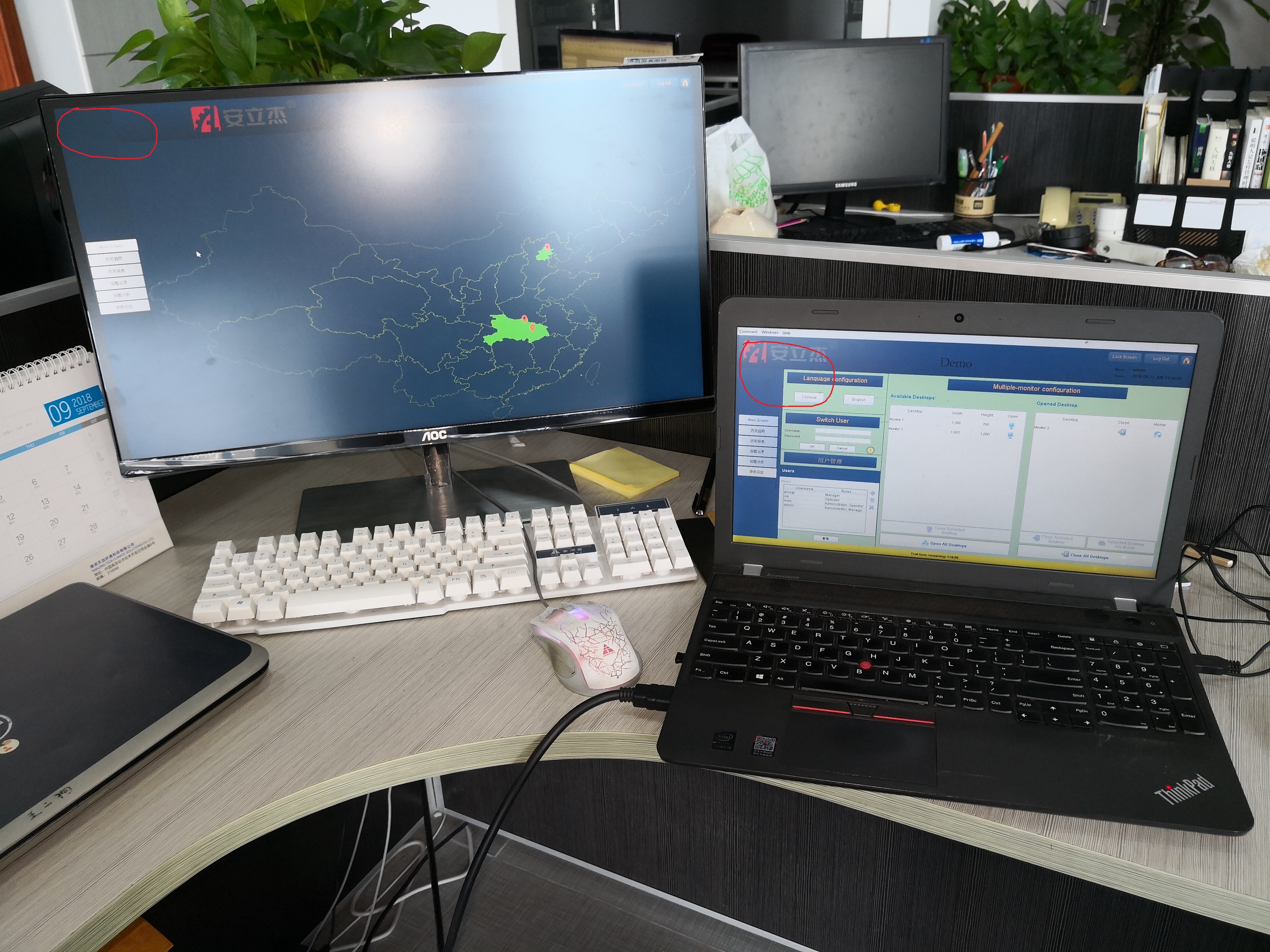

I found that the layout of secondary desktop is different from the primary desktop. I configured "Axis Precedence " as “North/South” while the layout of secondary desktop seems like “East/West”. Is it a bug or is there any configuration on it? I use Ignition v7.9.7.
 ![](https://us1.discourse-cdn.com/inductiveautomation/original/2X/9/9a20deb9c05a7ca10a5bb68808363d5d7c6ac7ff.jpg)

Try changing the layout to Anchored
**Post date:** [September 27, 2018, 2:48pm UTC](https://forum.inductiveautomation.com/t/layout-of-multiple-sceens/19851/3 "2018-09-27T14:48:10Z")
The axis precedence (and a few other project-level settings) don’t inherit correctly on secondary desktops. That bug has been fixed in a future release (probably 7.9.11). If you get in contact with support, they can get you set up with a workaround - it’s a little “hacky” and there are caveats around it, so I don’t want to publicly post it here.
