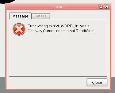

Im unable to write tags using modbus tcp devices on the OPC-UA Server
Getting the error message:
[color=#FF0000]“Error writing to MW\_WORD\_01.value: Gateway Comm Mode is not Read/Write.”[/color]
When I monitor the communication with the programm Wireshark I only see modbus read instructions and no write instructions
Can it be that this is caused by limitations in the demo version of Ignition
As far as I can see I dont have a option to set a read or write option in the modbus-tcp driver
I Have put a Image of the error message as atachment
Does anybody experience the same problem

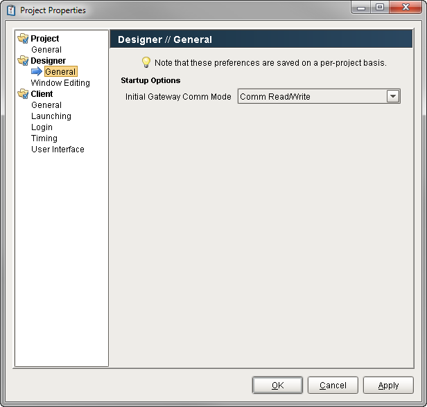

Here’s a few dumb questions: Is this problem in the designer? If so, what mode is the designer in?
**Post date:** [January 4, 2012, 4:07pm UTC](https://forum.inductiveautomation.com/t/limitations-demo-version/3820/3 "2012-01-04T16:07:11Z")
I PM’d you on this from our conversation, but here’s the “public” version. 😉
In the designer: ![](https://us1.discourse-cdn.com/inductiveautomation/original/1X/46b76efa555c151a011621c6559fb68b1358c87f.png)
Also, if you go the Project properties dialog:
 ![](https://us1.discourse-cdn.com/inductiveautomation/original/1X/c05c5cae0ef9c72f304eb0346a1ee782d28a9b98.png)

Problem solved
The problem was in the Designer
I have changed the mode to read and write enable.
Thanks for your support
