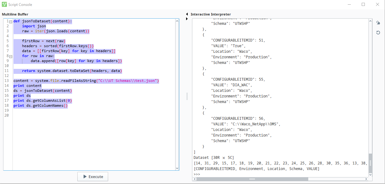

**Author:** ![mrutten](https://avatars.discourse-cdn.com/v4/letter/m/c0e974/32.png) [@mrutten](https://forum.inductiveautomation.com/u/mrutten)\
**Post date:** [January 12, 2023, 3:18pm UTC](https://forum.inductiveautomation.com/t/load-json-file-and-convert-to-dataset/68518/3 "2023-01-12T15:18:05Z")
Paul,
Thank you.
When I run this in script console it works fine.
But when I have a window and add the same code to a button, it fails?
 ![](https://us1.discourse-cdn.com/inductiveautomation/original/3X/4/9/4985e5bc75c107aece3d26ea371c8586dda5bd89.png)
Button code:
**def** jsonToDataset(content):
**import** json
raw = iter(json.loads(content))
firstRow = next(raw)
headers = sorted(firstRow.keys())
data = [[firstRow[key] **for** key **in** headers]]
**for** row **in** raw:
data.append([row[key] **for** key **in** headers])
**return** system.dataset.toDataSet(headers, data)
content = system.file.readFileAsString("C:\UT Schemas\test.json")
**print** content
ds = jsonToDataset(content)
**print** ds
**print** ds.getColumnAsList(0)
**print** ds.getColumnNames()
_#event.source.parent.getComponent('Table').data = ds_
Button error:
 ![](https://us1.discourse-cdn.com/inductiveautomation/original/3X/5/2/52d0e4c6058a9567f4be4f94dfa645766c91d6f7.png)
Marcel.
**Post date:** [January 12, 2023, 5:27pm UTC](https://forum.inductiveautomation.com/t/load-json-file-and-convert-to-dataset/68518/5 "2023-01-12T17:27:53Z")
That did it. Thank you very much.
Now it is working correctly.
Here is the solution with the help from Paul and Victor.
I created a new window.
added a button and a table
Code I put in the button.
def jsonToDataset(content):
import json
data = [[firstRow[key] for key in headers]]
for row in raw:
	data.append([row[key] for key in headers])
return system.dataset.toDataSet(headers, data)
print ds
print ds.getColumnAsList(0)
print ds.getColumnNames()
Screen shot.
 ![image](https://us1.discourse-cdn.com/inductiveautomation/original/3X/8/1/814004373b705365dd473edc09512977276a6cec.png)
