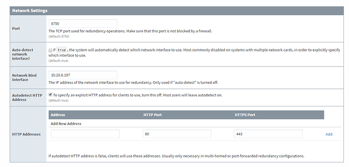

**Post date:** [May 9, 2017, 5:23pm UTC](https://forum.inductiveautomation.com/t/local-client-link-problem/14240/2 "2017-05-09T17:23:56Z")
Try forcing the list of addresses given to clients - even if you’re not using redundancy, the ‘Network Settings’ section of the Redundancy configuration still applies to all clients:

**Post date:** [May 9, 2017, 7:09pm UTC](https://forum.inductiveautomation.com/t/local-client-link-problem/14240/3 "2017-05-09T19:09:53Z")
Alright. Trying that.
(For anyone else who finds this thread, use all possible IPs that clients would use to reach the Gateway.)
We’ll see on Thursday or Friday if it worked.

**Post date:** [May 13, 2017, 5:33pm UTC](https://forum.inductiveautomation.com/t/local-client-link-problem/14240/4 "2017-05-13T17:33:30Z")
Problem reoccurred.
Do these settings look correct?
 ![](https://us1.discourse-cdn.com/inductiveautomation/original/2X/c/c68ba144414d1663f69508194726bf4974a01739.PNG)
