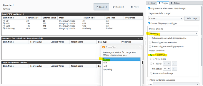

**Author:** ![Matrix\_Engineering](https://sea1.discourse-cdn.com/inductiveautomation/user_avatar/forum.inductiveautomation.com/matrix_engineering/32/19781_2.png) [@Matrix\_Engineering](https://forum.inductiveautomation.com/u/Matrix_Engineering)\
**Post date:** [November 8, 2025, 5:30am UTC](https://forum.inductiveautomation.com/t/log-tag-values-to-database-table/111949/10 "2025-11-08T05:30:02Z")
Try this (I Haven’t tested it):
 ![image](https://us1.discourse-cdn.com/inductiveautomation/original/3X/d/3/d33e6d829676037c7786cc1351586c7874ba50e1.png)
 ![image](https://us1.discourse-cdn.com/inductiveautomation/original/3X/c/f/cf258fa7d355d26f79593385d6cf498c7e72d617.png)
> **[Trigger – On Value Change Video at Inductive University](https://inductiveuniversity.com/videos/trigger-on-value-change/8.3)**
> Learn how to configure a Transaction Group to only trigger when a value has changed, using either the Timer or Schedule option of the Execution Scheduling setting.
This video and the next one are the ones you want.

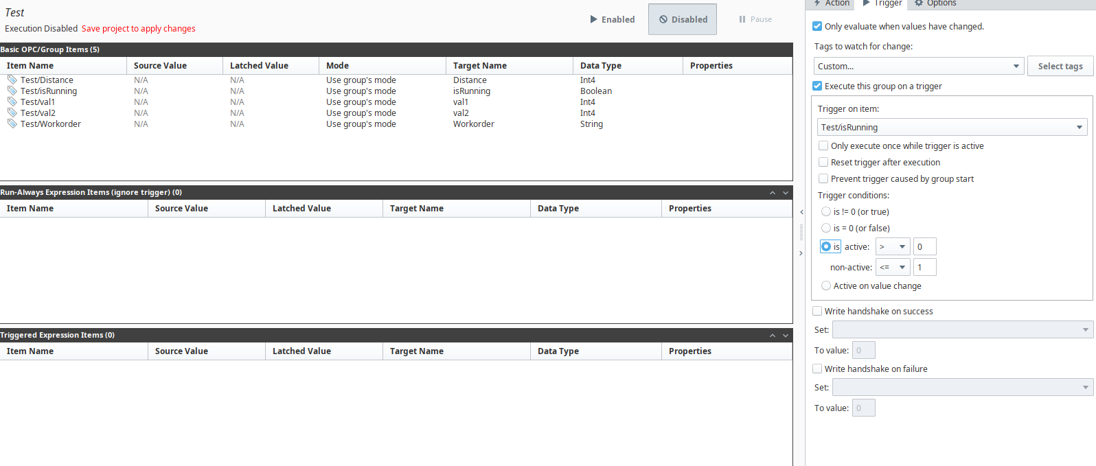

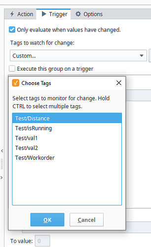

**Author:** ![Eugene49](https://avatars.discourse-cdn.com/v4/letter/e/c6cbf5/32.png) [@Eugene49](https://forum.inductiveautomation.com/u/Eugene49)\
**Post date:** [November 8, 2025, 5:36am UTC](https://forum.inductiveautomation.com/t/log-tag-values-to-database-table/111949/12 "2025-11-08T05:36:22Z")
> [@Matrix\_Engineering](#):
Thanks, i will try.
I got confused on "Run Always Expression and Trigger Expression" vs the trigger tab.
I guess just a matter of getting familiar.
Edit:
I now got clear on my confusion.
On item table: Run Always and Trigger refers to the expression being executed always or once when triggered. And not referring to the Running or triggering the group to log.
**Post date:** [November 8, 2025, 9:56pm UTC](https://forum.inductiveautomation.com/t/log-tag-values-to-database-table/111949/13 "2025-11-08T21:56:50Z")
Thanks.
I got it.
