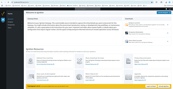

I just installed 8.3 and the gateway tells me I have to restart the trial but requires login and admin password does not work.
 ![image](https://us1.discourse-cdn.com/inductiveautomation/original/3X/4/8/484f9d7af57f1c279a3f9a06963d406973a7437c.png)
**Post date:** [July 30, 2025, 6:42pm UTC](https://forum.inductiveautomation.com/t/logging-in-to-8-3-to-reset-trial/109163/2 "2025-07-30T18:42:29Z")
The procedure to reset the system user source is the same (via `gwcmd`). If this was a completely fresh install, you should have gotten a commissioning stage where you choose a password - if you didn't, then this was likely restoring a backup (possibly from an old local install of Ignition?).

I had 8.1.28 installed previously and during installation I wasn't asked for anything and I didn't change anything at the prompts.
**Post date:** [July 30, 2025, 6:58pm UTC](https://forum.inductiveautomation.com/t/logging-in-to-8-3-to-reset-trial/109163/4 "2025-07-30T18:58:03Z")
Then your login should be the same as it was for the 8.1 gateway; from the installer's point of view you asked it to upgrade from 8.1.28 to 8.3.0. There's nothing in the installer that will attempt to make a 'separate' install for the beta.
If you need to reset the system login, you can do so with the bundled command line utility:

I am very familiar with that, just didn't know I would have to use it when upgrading since all my users and passwords usually follow.
**Post date:** [July 30, 2025, 7:30pm UTC](https://forum.inductiveautomation.com/t/logging-in-to-8-3-to-reset-trial/109163/6 "2025-07-30T19:30:12Z")
Okay, so it sounds like the problem here is that you did an upgrade and it didn't carry over your identity provider/user source settings. That's definitely a problem we want to address.
Do you happen to have a gateway backup from the 8.1.28 system before you did the upgrade?
