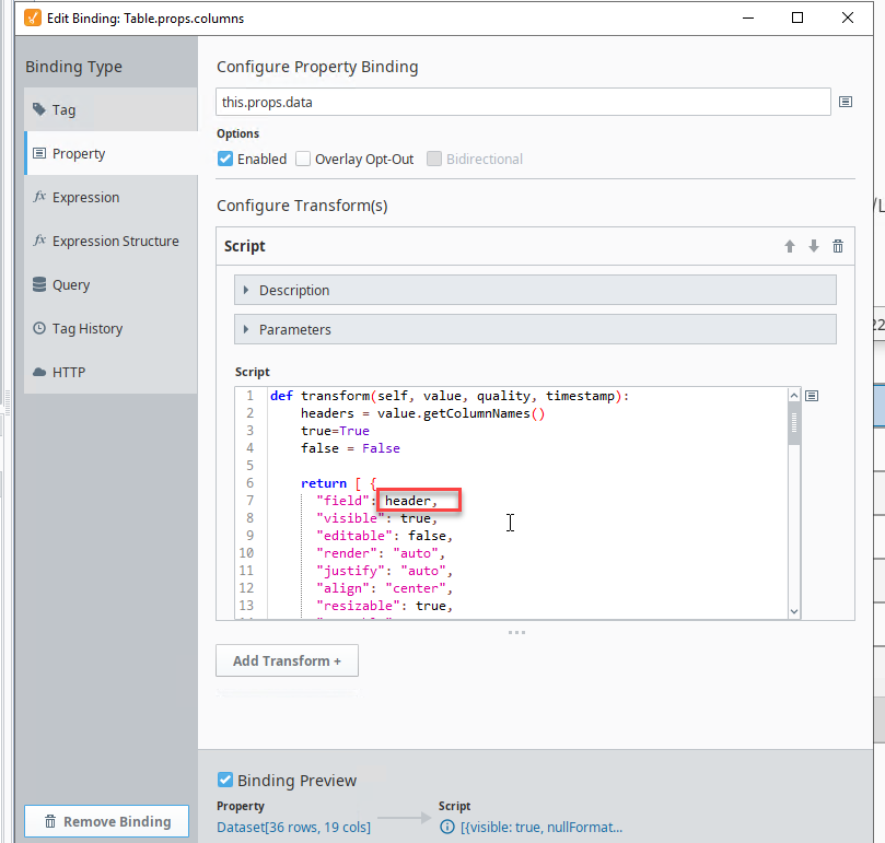

Is it possible to add some logic in one of the fields
This script loops through my dataset and creates all the columns based on my headers in the dataset.
But I would like to be able to change the Title based on my header Value,
![image](https://us1.discourse-cdn.com/inductiveautomation/original/3X/d/9/d9c2e8f537d42c07dd578e9a93dfe436de5c1c36.png)
 ![image](https://us1.discourse-cdn.com/inductiveautomation/original/3X/f/d/fd05e8cf6cf85290d7bc95e0a2ea8010401c76cd.png)

**Author:** ![pascal.fragnoud](https://sea1.discourse-cdn.com/inductiveautomation/user_avatar/forum.inductiveautomation.com/pascal.fragnoud/32/24728_2.png) [@pascal.fragnoud](https://forum.inductiveautomation.com/u/pascal.fragnoud)\
**Post date:** [June 15, 2023, 9:31am UTC](https://forum.inductiveautomation.com/t/logic-within-json/75064/2 "2023-06-15T09:31:49Z")
This is not json, this is a python dict. You can do whatever you want that's allowed by python.
```python
return [
        'header': {
            'title': header.title().replace('_', ' ').whateveryouwant()
    } for header in headers
> [@hans\_odgaard](#):
> ```python
> true=True
> false = False

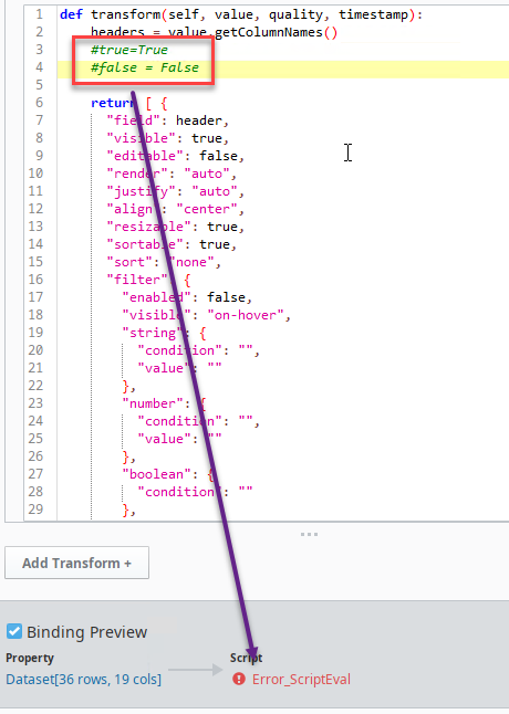

Why ?
**Author:** ![hans\_odgaard](https://sea1.discourse-cdn.com/inductiveautomation/user_avatar/forum.inductiveautomation.com/hans_odgaard/32/83110_2.png) [@hans\_odgaard](https://forum.inductiveautomation.com/u/hans_odgaard)\
**Post date:** [June 15, 2023, 10:17am UTC](https://forum.inductiveautomation.com/t/logic-within-json/75064/3 "2023-06-15T10:17:47Z")
![image](https://us1.discourse-cdn.com/inductiveautomation/original/3X/9/5/95b3bb6d5e3930ee13b5ff19c92eeebe62ffd1e9.png)
That's why,
I haven't tested by simply replacing them, here I could simply copy paste the column setup from the table
