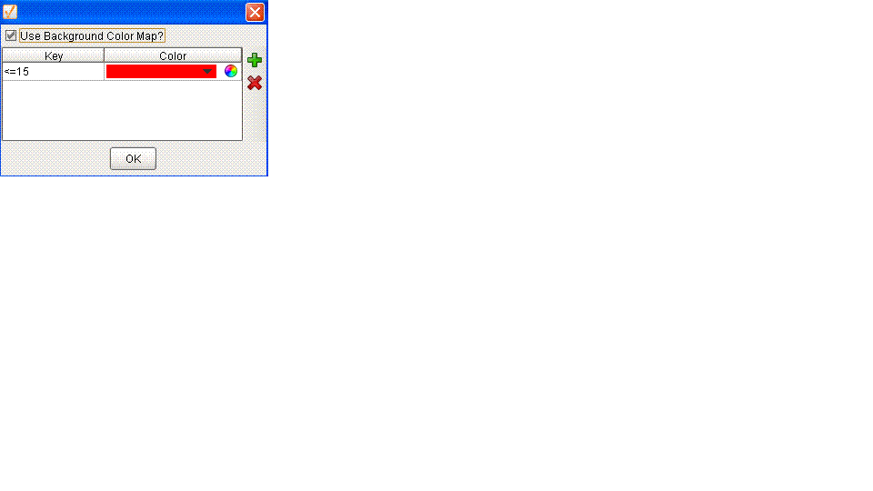

Hi
I am wondering if it possible to have \<= , \>= or != etc in the background color translation list in a table. I can only get it to work when a value is equal to a value in the column.
Thanks
Aidan
 ![](https://us1.discourse-cdn.com/inductiveautomation/original/1X/900517b03163297ddbedd145947de4511d067f13.GIF)
**Author:** ![Travis.Cox](https://avatars.discourse-cdn.com/v4/letter/t/b9bd4f/32.png) [@Travis.Cox](https://forum.inductiveautomation.com/u/Travis.Cox)\
**Post date:** [February 24, 2011, 6:30pm UTC](https://forum.inductiveautomation.com/t/logical-operators-in-table-column-translation-list/2692/2 "2011-02-24T18:30:11Z")
We don’t have those operators right now. However, you can do the same in your SQL query. You can do something like:`SELECT CASE WHEN value <= 15 THEN 1 WHEN value > 15 THEN 2 ELSE 3 END FROM Table..`Then your background color mapping is simple. Hope this helps.

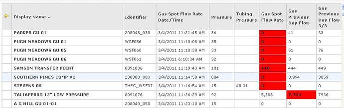

Carl, whats the chances of more customization for cell backgrounds being made available? In particular, I would love to be able to just assign the cell background based on the alert status of the tag in each cell.
this is a competitors software, cygnet.
 ![](https://us1.discourse-cdn.com/inductiveautomation/original/1X/18dd41b02e7db2f7fb741c1b5b058b424714927c.JPG)
**Author:** ![Carl.Gould](https://sea1.discourse-cdn.com/inductiveautomation/user_avatar/forum.inductiveautomation.com/carl.gould/32/7262_2.png) [@Carl.Gould](https://forum.inductiveautomation.com/u/Carl.Gould)\
**Post date:** [March 4, 2011, 9:33pm UTC](https://forum.inductiveautomation.com/t/logical-operators-in-table-column-translation-list/2692/8 "2011-03-04T21:33:37Z")
Well the tricky thing here is that our Table component is really general-purpose. It has no notion of the concept of a tag, so there is no “tag” associated with a row. For all it knows the data came out of a SQL database and has nothing to do with tags.
I have a vague idea for a more generalized table-like component that would let you essentially define a wide container as a “row template” that would then at runtime become duplicated X times with different values for some property. This would let you build extremely customized “tables” that could do whatever your heart desired. (As well as a host of other useful things) Still on the drafting table though.
