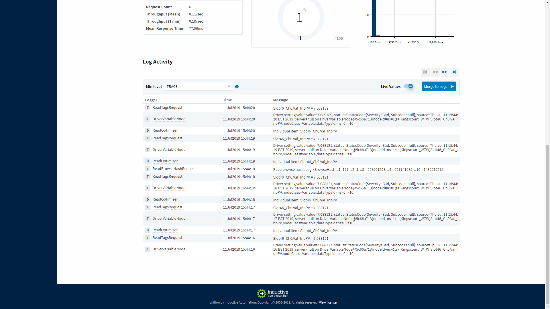

I am connected to a compactlogix L36E via VPN. I’m using an Allen-Bradley Logix Driver. My tags are perfectly healthy, all values are reading correctly and changing when they’re supposed to, but they’re all marked as ‘bad quality’. Any ideas?
**Post date:** [July 11, 2019, 11:55am UTC](https://forum.inductiveautomation.com/t/logix-driver-bad-quality/26469/2 "2019-07-11T11:55:43Z")
What version of Ignition is this?
There should be a link to a diagnostics page in the gateway next to the device entry. Take a look at that page and see what the response times and load factors are. Feel free to provide a screenshot of the page as well.
**Author:** ![jonathan1](https://avatars.discourse-cdn.com/v4/letter/j/f14d63/32.png) [@jonathan1](https://forum.inductiveautomation.com/u/jonathan1)\
**Post date:** [July 11, 2019, 2:51pm UTC](https://forum.inductiveautomation.com/t/logix-driver-bad-quality/26469/3 "2019-07-11T14:51:31Z")
Version is 7.9.10
 ![Screenshot1](https://us1.discourse-cdn.com/inductiveautomation/original/2X/2/29a2b6a9cd08b970519dbc64c574b198391e6d7d.png)
 ![Screenshot2](https://us1.discourse-cdn.com/inductiveautomation/original/2X/0/08965081701339da8a1ab12e034bff13f0db9d77.png)
**Post date:** [July 11, 2019, 2:54pm UTC](https://forum.inductiveautomation.com/t/logix-driver-bad-quality/26469/4 "2019-07-11T14:54:09Z")
Hmm, diagnostics look fine. Not sure where the bad quality is getting set.
I see your trial is expired - is the Logix Driver module part of your license?
**Post date:** [July 11, 2019, 3:13pm UTC](https://forum.inductiveautomation.com/t/logix-driver-bad-quality/26469/5 "2019-07-11T15:13:29Z")
The driver isn’t licensed, that’s the problem. Thank you Kevin
