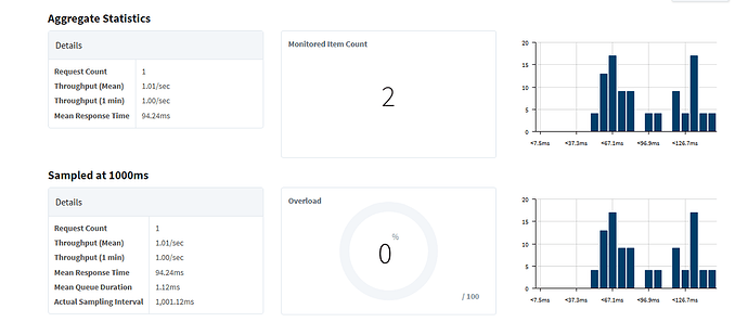

I’m having some issues with response times and as a result, overloading on OPC communications to several PLC-5/40Es at a plant we are converting from Wonderware to Ignition.
 ![image](https://us1.discourse-cdn.com/inductiveautomation/original/3X/1/b/1b0dc6a033a8b0dfe78136054a554a7eaba80b63.png)
What I have tried:
1. Moved many tags to higher sample rate tag groups or leased tag groups. This lowered Overload from ~600% to what you see above, but it seems the ‘Mean Response Time’ has no change no matter how many tags i’m polling. More on that later.
2. Changing the ‘Communications Time Slice’ parameter S:77 in the PLC-5 to allow more time for communication processing. This had no effect.
3. Monitored traffic on the switch port this PLC is connected to. I know the PLC-5/40E is limited to 10 Mbps, but I only see 300 - 500 Kbps of activity on the line, so that didn’t seem to be the bottleneck.
4. Tested a small amount of tag connections for another PLC-5/40E for which I had no other tags configured yet. You can see it is not yet experiencing significant overload, but the response time still sits at ~95 ms.
 ![image](https://us1.discourse-cdn.com/inductiveautomation/original/3X/9/6/9647a8a2c39ca19684a2ca94aee9c426578da6c8.png)
1. Took a look at the communication data from their existing Wonderware system to all the PLC-5s and SLCs in the plant. It seems to be a pre-existing issue, as you can see here there are really bad update times from all PLCs.
 ![image](https://us1.discourse-cdn.com/inductiveautomation/original/3X/e/f/efb11043343a8ba8f9dba78ba3208a648c8bedec.png)
Is there a physical limitation of the PLC-5/40E that could be causing these slow speeds? At this point I am thinking it must be something on that end, or else a physical bottleneck somewhere in the network between the server and the PLC.

So, first thing here is that if you are subscribing to the tags while wonderware is still connected, you are doubling the comms overload on the PLC.
If you want to test the different tag polling rates, change all your tags to the same rates, that way you can guarantee that any optimisation of the connection can be done over all your tags.
What settings are you using on your driver?

Yes. It is old technology with a single-threaded and rather slow CPU. Your only hope for improvement will be to consolidate information into just a few PLC files, and only about 250 bytes per each.
(And only one client, WW or Ignition, at a time.)
Also, consider splitting the main task into pieces. Comms can only be handled between logic scans, and I bet your scan time is ~90-100ms.

Curiously enough, the scan time is about 10-20 ms. I did try to modify the communications time slice parameter S:77 as well to manually give time for handling comms, but that seemed to have no effect on the response times.
I’ll turn off communications from Wonderware to this PLC when I have the opportunity and see what kind of improvement we get there.
