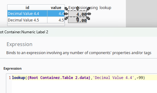

Hi, I'm trying to lookup a decimal value from a dataset. I get an integer in return.
-Am I doing something wrong?
see attached screenshot:

The user manual `lookup` page states:
**lookup(dataset, lookupValue, noMatchValue, [lookupColumn], [resultColumn])**
> **Note:** The type of the value returned will always be coerced to be the same type as the noMatchValue.
So your expression
`lookup({Root Continer.Table 2.data}, 'Decimal Value 4.4', -99)`
reads,
- lookup the data dataset,
- find a string with literal value 'Decimal Value 4.4',
- if not found then return value '-99', **otherwise format the result as an integer** ,
- search for the lookup value in column 0 (default),
- return the value from column 1 (default).
[https://docs.inductiveautomation.com/display/DOC81/lookup](https://docs.inductiveautomation.com/display/DOC81/lookup)
Try changing the default to `-99.0`.
