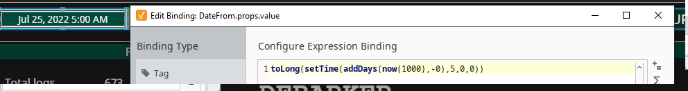

I’m trying to set the date from components always at a certain time with settime(), but seems like this function makes the components can not be changed, it always change back to the settime(). Is there anyway we can display at a certain time after reload the browser, but also changable?
Cheers all,

`now(1000)` will cause the binding to update every second.
`now(0)` will update once when the view is loaded.
> [@uy\_huynh](#):
Not with a simple expression, I suspect. Why do you need a delay?

```auto
addHours(midnight(now(0)), 5)

Cheers! I thought the settime is the one that keeps updating.Silly me!
