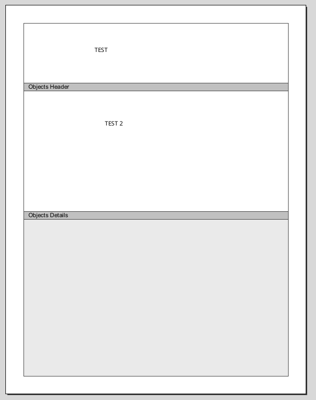

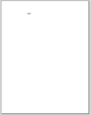

I have a report setup as follows:
 ![image](https://us1.discourse-cdn.com/inductiveautomation/original/3X/e/d/edeb446f4261ee1caff342f457cb779a9d665e18.png)
 ![image](https://us1.discourse-cdn.com/inductiveautomation/original/3X/8/c/8cdc757619fbd60d348c69b2a5c8fe4356d232d5.png)
 ![image](https://us1.discourse-cdn.com/inductiveautomation/original/3X/a/9/a9a13114bfa60293695a2d1decfbde63fbac2b8b.png)
There is a single table in the report and the header / details each have a text shape. The header and details are **both set to unstructured**. My problem is the text shape in the details does not appear in the preview.
Anyone know what setting this is to make the text shape show up in the details section on the preview tab?
**Post date:** [September 17, 2025, 4:06pm UTC](https://forum.inductiveautomation.com/t/make-unstructured-details-appear-in-the-report-module/110715/2 "2025-09-17T16:06:24Z")
I think it'll only show up if bound to a data key with some amount of "real" data (there may be some way to force the row to show up anyways, but that's probably easiest).
**Author:** ![bmeyers](https://sea1.discourse-cdn.com/inductiveautomation/user_avatar/forum.inductiveautomation.com/bmeyers/32/37453_2.png) [@bmeyers](https://forum.inductiveautomation.com/u/bmeyers)\
**Post date:** [September 17, 2025, 4:14pm UTC](https://forum.inductiveautomation.com/t/make-unstructured-details-appear-in-the-report-module/110715/3 "2025-09-17T16:14:49Z")
Ok, you were right. I had to create a static data source with a one row of data and then set the Data Key to that Data Source.
