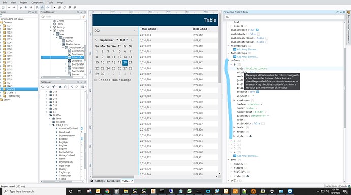

This only works if we don’t want all the data to be returned from the Select query. What are our options if we want all the data returned but don’t want to show it all in the table? The Vision table components give us the ability to easily hide columns. Can we do this same thing in Perspective?
**Post date:** [October 3, 2019, 8:08pm UTC](https://forum.inductiveautomation.com/t/making-a-column-invisible-in-a-table/22464/4 "2019-10-03T20:08:14Z")
Yes, since that post was originally made an option was added to the table that allows you to hide a column from display but still access its data. I believe this is available in 8.0.4, but I could be wrong.
**Author:** ![wking](https://sea1.discourse-cdn.com/inductiveautomation/user_avatar/forum.inductiveautomation.com/wking/32/21823_2.png) [@wking](https://forum.inductiveautomation.com/u/wking)\
**Post date:** [October 3, 2019, 8:13pm UTC](https://forum.inductiveautomation.com/t/making-a-column-invisible-in-a-table/22464/5 "2019-10-03T20:13:03Z")
You have to set the columns up in the props first. Field: = the column name from query. Then all the props show up
