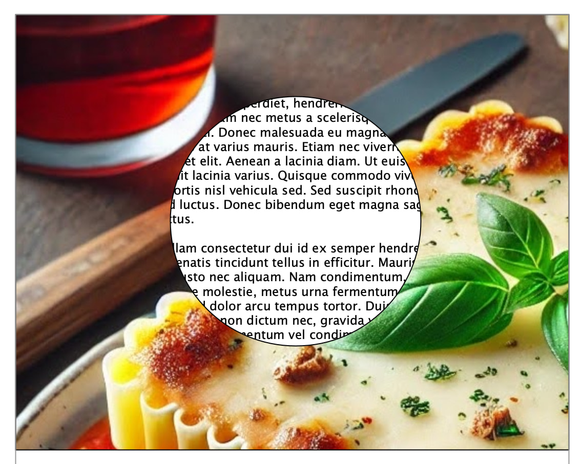

I'm building a report and I have an image that I want to apply a circular mask to. I tried the radius and it looks like it draws underneath the image. I also tried using a circle shape component and setting the z level higher but I'm not having any luck getting the transparency to "flip", as in a transparent center with a filled border to the bounds of the box.
Has anyone tried this with any success?

Something like this?
 ![image](https://us1.discourse-cdn.com/inductiveautomation/original/3X/7/c/7c95c75029c79a8be3c33955e632453662791dfd.jpeg)

I was looking for the opposite.
I did figure out a way to do it: place a rectangle give it some fill, add a circle then use the `difference` tool to subtract the circle from the rectangle and use that combined shape as a mask for the image
 ![image](https://us1.discourse-cdn.com/inductiveautomation/original/3X/f/6/f6f8df69dba3f3a2b067e88cf279046cc5e8902e.png)
edit: You've got me curious though, what's the method for your example?

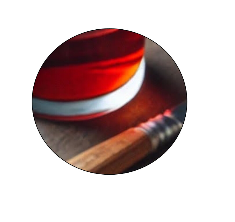

**Author:** ![Vi\_Quang](https://sea1.discourse-cdn.com/inductiveautomation/user_avatar/forum.inductiveautomation.com/vi_quang/32/82707_2.png) [@Vi\_Quang](https://forum.inductiveautomation.com/u/Vi_Quang)\
**Post date:** [November 25, 2025, 6:28pm UTC](https://forum.inductiveautomation.com/t/masking-an-image-in-reports/112424/5 "2025-11-25T18:28:01Z")
I’m not sure what you’re trying to do, but if it’s just to apply a circular mask. Then you can drop an image on the ellipse itself:
 ![image](https://us1.discourse-cdn.com/inductiveautomation/original/3X/c/0/c0f145738d2bbc7d75b76346fe3a89760f980457.jpeg)
The negative about this, is that it doesn’t appear that you can scale or adjust the offset of the image.
