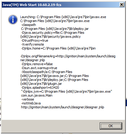

**Author:** ![Dan\_Bridgeman](https://sea1.discourse-cdn.com/inductiveautomation/user_avatar/forum.inductiveautomation.com/dan_bridgeman/32/3610_2.png) [@Dan\_Bridgeman](https://forum.inductiveautomation.com/u/Dan_Bridgeman)\
**Post date:** [July 16, 2014, 2:03pm UTC](https://forum.inductiveautomation.com/t/maximum-available-memory-in-designer/8635/9 "2014-07-16T14:03:08Z")
I don’t see anything in there giving the memory allocation, but here’s the Web Start screen:
![](https://us1.discourse-cdn.com/inductiveautomation/original/2X/3/38246ea46ea46fe5f4160b93713ee72bcea01ae9.PNG)
**Author:** ![mgross](https://sea1.discourse-cdn.com/inductiveautomation/user_avatar/forum.inductiveautomation.com/mgross/32/3311_2.png) [@mgross](https://forum.inductiveautomation.com/u/mgross)\
**Post date:** [July 17, 2014, 2:30pm UTC](https://forum.inductiveautomation.com/t/maximum-available-memory-in-designer/8635/10 "2014-07-17T14:30:35Z")
Your verbose output looks very different than what I see on my systems. I am somewhat confused on why it can be so different. Can you PM me the contents of your designer.jnlp file? Also, can you include the version of Ignition that you are currently running?
**Post date:** [July 18, 2014, 1:30pm UTC](https://forum.inductiveautomation.com/t/maximum-available-memory-in-designer/8635/11 "2014-07-18T13:30:27Z")
Mystery solved! My \_JAVA\_OPTIONS environment variable was set to “-Xmx512MB”, which capped the memory at under half a gig. Removing this option caused it to fail to launch at all, which eventually led me to figure out that I was running a 32-bit JRE on my 64-bit virtual desktop. I downloaded a 64-bit JRE, uninstalled the old ones, and I’m back in business with 1824 MB of memory available in my designer. ![:thumb_left:](https://us1.discourse-cdn.com/inductiveautomation/original/1X/e26afb081ddde6df016df6ee49159cf56aaca688.gif ":thumb\_left:")
