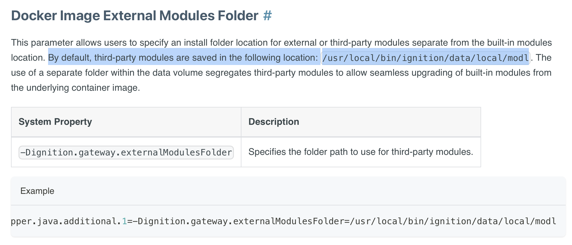

**Author:** ![hunterdg](https://sea1.discourse-cdn.com/inductiveautomation/user_avatar/forum.inductiveautomation.com/hunterdg/32/67774_2.png) [@hunterdg](https://forum.inductiveautomation.com/u/hunterdg)\
**Post date:** [October 22, 2025, 4:00pm UTC](https://forum.inductiveautomation.com/t/merging-wrapper-arguments-in-docker/67112/5 "2025-10-22T16:00:08Z")
out of curiosity, why is the 8.3 external modules folder different in docs vs .ignition-jvm-args?
my compose command:
```python
    command: >
      -Dignition.projects.scanFrequency=5
but found in .ignition-jvm-args.\<8 random chars\>:
`-Dignition.gateway.externalModulesFolder=data/var/ignition/modl`
[docs](https://www.docs.inductiveautomation.com/docs/8.3/appendix/reference-pages/gateway-configuration-file-reference/gateway-and-gateway-network-parameters#docker-image-external-modules-folder):
 ![image](https://us1.discourse-cdn.com/inductiveautomation/original/3X/6/f/6fc438e21219d47c906114b4b80cee55c92ad38e.png)
