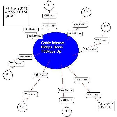

**Author:** ![jgreenewv](https://avatars.discourse-cdn.com/v4/letter/j/919ad9/32.png) [@jgreenewv](https://forum.inductiveautomation.com/u/jgreenewv)\
**Post date:** [April 20, 2010, 4:38pm UTC](https://forum.inductiveautomation.com/t/micrologix-driver-losing-connection/1761/7 "2010-04-20T16:38:50Z")
Yeah, a diagram might help. I wasn’t completely awake yet when I posted this morning. 😆
All of the PLCs, the client, and the server are sitting on a VPN. Stability is pretty good when I initially restart the server, with a site or two dropping out every few minutes, but over time the dropouts become more frequent and longer duration.
I’m spending this afternoon working on the kinks in the VPN endpoint, routers, and cable modems, so if there is anything you can think of for me to check, I’ll have access to the system. Thanks.

I think your diagram is missing some things. How does this VPN work? Is it a separate router, software, or built into the cable modem? Is there a cable modem attached to each of the outer nodes?
**Post date:** [April 20, 2010, 9:08pm UTC](https://forum.inductiveautomation.com/t/micrologix-driver-losing-connection/1761/9 "2010-04-20T21:08:03Z")
Sorry, all I have to work with is MS Paint, and I have no artistic skills, so I was trying to keep it simple. Here is a (hopefully) complete layout.

**Author:** ![Carl.Gould](https://sea1.discourse-cdn.com/inductiveautomation/user_avatar/forum.inductiveautomation.com/carl.gould/32/7262_2.png) [@Carl.Gould](https://forum.inductiveautomation.com/u/Carl.Gould)\
**Post date:** [April 20, 2010, 9:18pm UTC](https://forum.inductiveautomation.com/t/micrologix-driver-losing-connection/1761/10 "2010-04-20T21:18:06Z")
Ok, thats better. So each device is on its own, huh? Everything must go through the VPN to talk to anything else. In that case putting the panel edition on the client won’t do a thing. My instinct tells me that your vpn routers are to blame (I’ve found that the quality of “VPN” implementations from vendor-to-vendor and flavor-to-flavor vary greatly). Unfortunately it is difficult to troubleshoot this sort of thing.
Your best clue is the message “An established connection was aborted by the software in your host machine”. This seems to be caused when the TCP layer (in Windows) doesn’t receive an acknowledgement that data was sent correctly over a connection.
You might try bringing up the system slowly. For example, bring up the server, client, and one PLC. See if it can handle that. Then add a second PLC, etc. You may find that there is a saturation point at which the VPN and/or internet connection can no longer keep up.
This sort of troubleshooting isn’t my strongest point. Perhaps someone with some stronger networking skills can chime in?

Could you describe your equipment and VPN setup/settings in more detail? We’re going to have to dig up more troubleshooting details to get to the root of the problem.

Yeah, I should have thought of Wireshark sooner. Here is the setup:
The Client PC and PLCs are sitting behind Cisco RVS4000 VPN Routers.
The server sits behind a Cisco RV082 VPN Router.
All cable modems are Scientific Atlantic model 2100.
VPN setup is as follows:
IPSec IKE with Preshared key
Subnet Security Group
768 bit
3DES encryption
MD5 Phase 1 Auth
SHA1 Phase 2 Auth
3600 sec key lifetime
I’m beginning to believe the problem is in the RV082. I have a separate VPN running between four of the PLCs for critical messaging, and it is running without a hitch on just the RVS4000 routers. I don’t have anything jumping out at me on Wireshark as a glaring error. I have a spare RVS4000 I am going to set up and see if that evens things out, and will report back whatever I find. Any ideas anyone comes up with before then are appreciated. Thanks.
