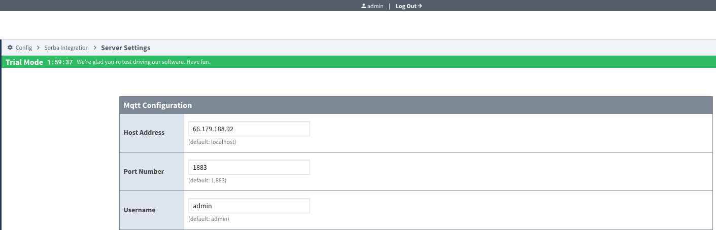

![image](https://us1.discourse-cdn.com/inductiveautomation/original/3X/7/9/7913ae238736e91cca6183ed5d3d944edc39c389.png)I previously had a section in the UI configuration. In version 8.3, how would I create this section, and where would this configuration be displayed? I've followed the examples, but it's not showing me anything.
**Post date:** [November 9, 2025, 5:33pm UTC](https://forum.inductiveautomation.com/t/migration-module-8-1-x-to-8-3-x/112015/4 "2025-11-09T17:33:52Z")
You need to follow this specific example:
> **[ignition-sdk-examples/webui-webpage at ignition-8.3 ·...](https://github.com/inductiveautomation/ignition-sdk-examples/tree/ignition-8.3/webui-webpage)**
> Ignition SDK Example Projects. Contribute to inductiveautomation/ignition-sdk-examples development by creating an account on GitHub.
Yes, as an example, it is so thin as to be practically transparent, but the critical details are there. (It adds a general menu entry to launch the example page.)
Everything you knew about v8.1's Wicket UI is entirely abandoned. You have to start over with React.
