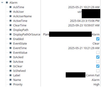

And the last Active and Ack events were when we were testing the system:
 ![image](https://us1.discourse-cdn.com/inductiveautomation/original/3X/6/1/6136740ad49270a446192b1e2ce325da19f3fa13.png)

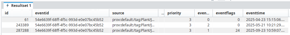

Querying the alarm database with the eventId gives the same result:
 ![image](https://us1.discourse-cdn.com/inductiveautomation/original/3X/5/f/5f28b1467b96d17f9fd797bbcd95828cabaa5130.png)
