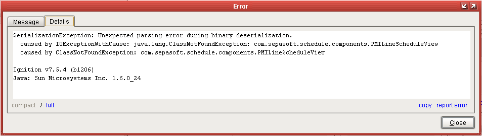

Ehhh… looks like it’s a deeper issue than that. I opened up a project with that component in it and I get this error:
 ![](https://us1.discourse-cdn.com/inductiveautomation/original/2X/4/4fffc8d256455b408c8a507e48a10c5f937b6cec.png)
Looks like this component actually isn’t in the build… weird… I upgraded to the beta and the component is now there but my production model won’t run, says it can’t find my Enterprise in the database.

I got the production model running again. Under the beta version the line schedule component is there and working. Something must have been wrong with the last stable release. FYI. Thanks!
