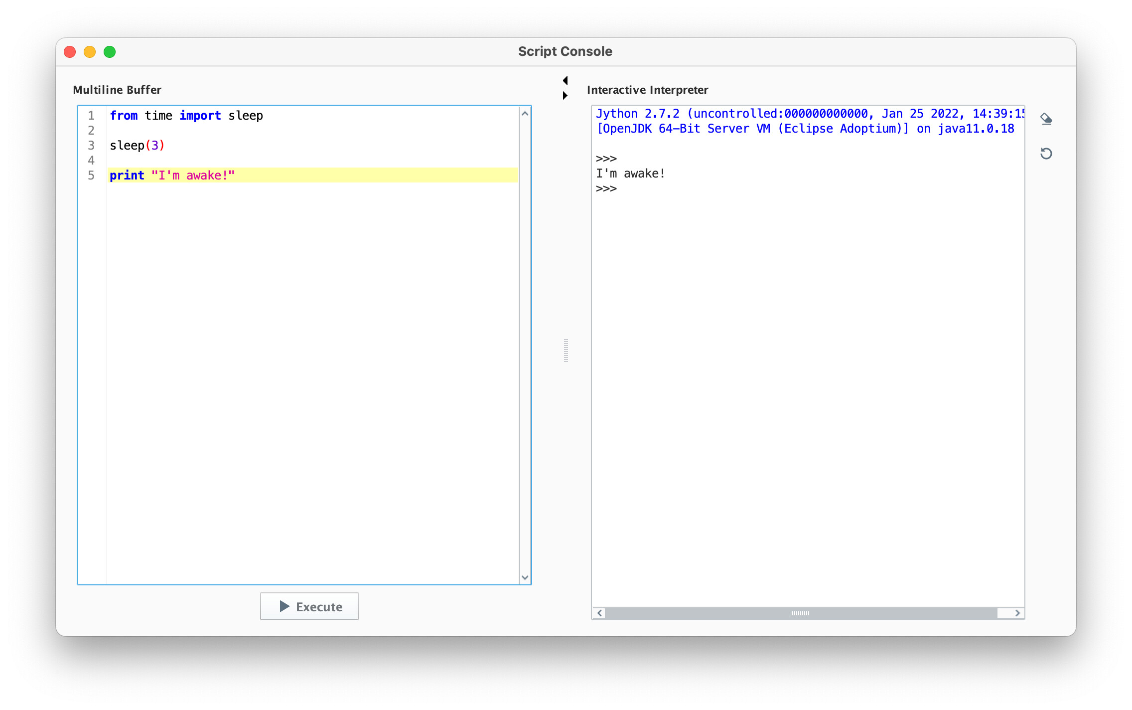

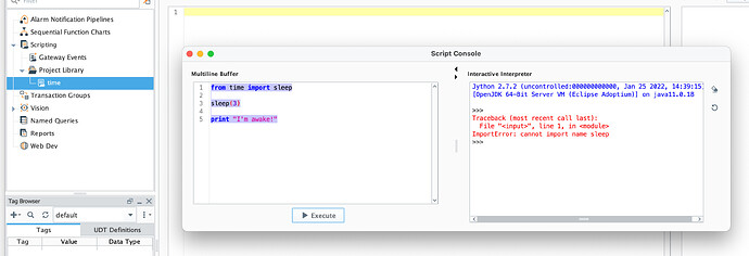

i'm somehow missing the time library. where can i find this or import it?
 ![image](https://us1.discourse-cdn.com/inductiveautomation/original/3X/f/1/f1671acc98a98793d5c22a78b6f12b6e493771c2.png)
 ![image](https://us1.discourse-cdn.com/inductiveautomation/original/3X/e/e/ee8688f80828fe30415c89f6e61ce48e62e42eeb.png)

What version of Ignition are you using? Do you happen to have a script library named "time" or something like that?

**Post date:** [May 22, 2023, 10:04pm UTC](https://forum.inductiveautomation.com/t/missing-time-library/74046/4 "2023-05-22T22:04:28Z")
No, I mean one defined in your project.
You shouldn't need to be messing around in the pylib folder for this to work, and shouldn't need to be adding any libraries.

**Post date:** [May 22, 2023, 10:06pm UTC](https://forum.inductiveautomation.com/t/missing-time-library/74046/6 "2023-05-22T22:06:39Z")
Yes. In your _project browser_, under 'Project Library', do you have a script or folder literally called `time`?
![image](https://us1.discourse-cdn.com/inductiveautomation/original/3X/8/b/8b8c3aa2968723b437b38ed3ccaaca095856b518.png)

**Author:** ![jesse.daniels](https://avatars.discourse-cdn.com/v4/letter/j/e36b37/32.png) [@jesse.daniels](https://forum.inductiveautomation.com/u/jesse.daniels)\
**Post date:** [May 22, 2023, 10:08pm UTC](https://forum.inductiveautomation.com/t/missing-time-library/74046/8 "2023-05-22T22:08:11Z")
oh no, nothing named "time"
**Post date:** [May 22, 2023, 10:10pm UTC](https://forum.inductiveautomation.com/t/missing-time-library/74046/9 "2023-05-22T22:10:03Z")
If this project inherits from another project, you'll have to check the parent (and its parents) as well.
Otherwise it's likely one of your scripts somewhere has exported over or otherwise clobbered that package somehow.

**Post date:** [May 22, 2023, 10:20pm UTC](https://forum.inductiveautomation.com/t/missing-time-library/74046/11 "2023-05-22T22:20:09Z")
What is the result of this script in the script console?
```auto
import time
print dir(time)
print type(time)
(copy/paste the result, don't screenshot)

@jesse.daniels - ~~Is your "L" in sleep actually a lowercase "L"? It sure looks like the number one "1" to me...~~ Edit: Never mind, just the font on your machine.
By the way, if ~~the~~ _ **a** _ time module didn't exist you would get an `ImportError: No module named time`.

hm, so i'm just missing the sleep definition from time?
**Post date:** [May 23, 2023, 2:00am UTC](https://forum.inductiveautomation.com/t/missing-time-library/74046/15 "2023-05-23T02:00:20Z")
No, something in your project is redefining `time`. It shouldn’t be of type `str`.
You might need to call support and let them try to help you find whatever you’ve done.
