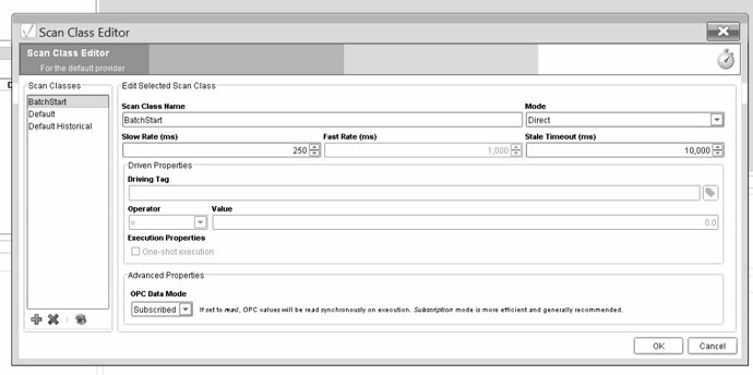

Being having this on and off issue with a client’s install where production data ‘does not add up’. Over the past couple of days, production data transaction records have failed to log to the database. Going online I see the following events in the transaction group:
 ![](https://us1.discourse-cdn.com/inductiveautomation/original/2X/0/0564fbbeee368431b817b40ef95f64dfb5cc899b.jpg)
The trigger is attached to a PLC LineBatchDoneTrigger which is a one shot latch ON from the PLC when new batch data is available to be recorded. It is the error shown here which I don’t completely understand.
This is the configuration:

**Author:** ![Curlyandshemp](https://avatars.discourse-cdn.com/v4/letter/c/bcef8e/32.png) [@Curlyandshemp](https://forum.inductiveautomation.com/u/Curlyandshemp)\
**Post date:** [March 22, 2013, 1:31pm UTC](https://forum.inductiveautomation.com/t/missing-transaction-records/6076/11 "2013-03-22T13:31:06Z")
Sorry Kevin,
stand corrected, there is one scan class that runs pretty fast:
 ![](https://us1.discourse-cdn.com/inductiveautomation/original/2X/2/24227e7e4855f2c7dc9680acd13107a1f5e1ca2e.jpg)
The default is 1,000ms
I went online and changed timeout from 2000 to 4000
Concurrent connections was set at 10
**Post date:** [March 22, 2013, 3:04pm UTC](https://forum.inductiveautomation.com/t/missing-transaction-records/6076/14 "2013-03-22T15:04:33Z")
There are only 3 tags in the fastest scan class:
 ![](https://us1.discourse-cdn.com/inductiveautomation/original/2X/4/4cb270326cf0c013bfd80151abeaeab54f986ee3.jpg)
The BatchDoneTrigger is the one causing the issue, but i noticed Line A is in the default scan class of 1000ms and Line B is at 250ms. Line A should also be in teh fastest scan class.
Line A is the one causing the most issues.

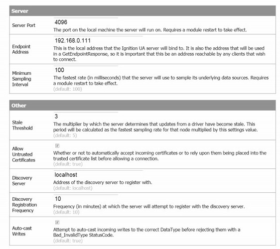

**Post date:** [March 22, 2013, 3:32pm UTC](https://forum.inductiveautomation.com/t/missing-transaction-records/6076/15 "2013-03-22T15:32:18Z")
One other setting worth checking the current value of: under the settings for Ignition OPC-UA Server there should be a ‘Stale Threshold’ setting… what’s the value of that?
When dealing with scan classes under 1s it’s relatively useless unless set to something high.
For example, with a 250ms rate and a 2000ms comm timeout, the stale threshold would need to be between 8 and 16 to even give a single timed out 250ms request a second chance to complete before marking the tags as stale.
**Post date:** [March 22, 2013, 3:49pm UTC](https://forum.inductiveautomation.com/t/missing-transaction-records/6076/16 "2013-03-22T15:49:43Z")
[quote=“Kevin.Herron”]One other setting worth checking the current value of: under the settings for Ignition OPC-UA Server there should be a ‘Stale Threshold’ setting… what’s the value of that?
For example, with a 250ms rate and a 2000ms comm timeout, the stale threshold would need to be between 8 and 16 to even give a single timed out 250ms request a second chance to complete before marking the tags as stale.[/quote]
screen shot of OPC-UA settings
 ![](https://us1.discourse-cdn.com/inductiveautomation/original/2X/8/884bd1ee029d043c3c456d4d3c33b2f17cf63124.jpg)
**Post date:** [March 22, 2013, 3:53pm UTC](https://forum.inductiveautomation.com/t/missing-transaction-records/6076/17 "2013-03-22T15:53:26Z")
Great.
Crank the Stale Threshold to 15, move the Communication Timeout on the driver down to 1500ms, leave Concurrent Requests at 10, restart the UA module, and report back in a day or so.
