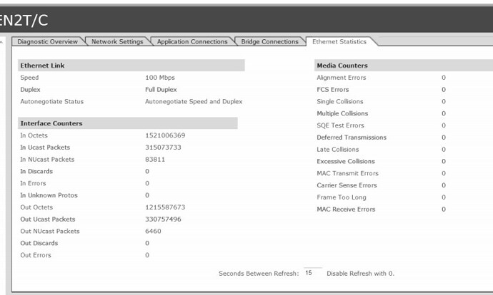

I’d suggest checking the 1756-E\*\*\* cards diag page. See if your diagnostic counters indicate you are close to the connection limit for the card.

Thanks for that, but its not an issue, i have a 1756-EN2T and ethernet and connections are fine:
 ![](https://us1.discourse-cdn.com/inductiveautomation/original/2X/1/1f6b89b45a97e916c7f0d8f591be3e491e007645.jpg)
 ![](https://us1.discourse-cdn.com/inductiveautomation/original/2X/1/1d4230096544ff3b52b953c5f625780d9fc4534d.jpg)
