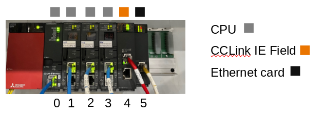

The ignition screenshots below are from Edge v8.3.1. This is very similar to our mitsubishi setup. I am trying to access a remote station on the IE field network. I have two routes, the PLC built in ethernet port, or an ethernet card on the rack. I am able to establish a connection to the PLC through both routes, but I am unable to read any of the remote station registers through the built in ethernet port. I suspect it’s because of something I didn’t set up correctly in the connection, because I do have 4 CPU modules on the host station rack. If there are any mitsubishi experts out there who can tell what I’m doing wrong by looking at the below pictures your assistance is greatly appreciated.

Here is a snip of my ethernet card open settings:
![Screenshot 2025-10-27 095353](https://us1.discourse-cdn.com/inductiveautomation/original/3X/2/0/208cbe61dbc04c6e768b4263c272463929edaf97.png)
This gets me to a connected state (and I’m able to see the value in my tag browser) with the following driver config:
 ![image](https://us1.discourse-cdn.com/inductiveautomation/original/3X/e/3/e372700ae69033ab674ac711a1a17fa9f48c8cfd.png)

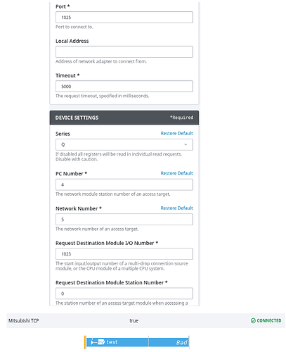

**Now if I try to connect through the built in Ethernet port:**

So if I set up my driver as shown, I get a good connection but I cannot read any of the registers on the remote station.
