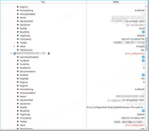

The Mitsubishi driver requires Area and Offset address components, but also allows many optional specifications. It’s important to know where the optional components must be placed in your address to properly connect. The example syntax below shows how optional data type (including modifiers) and array specifiers are listed before the Offset specification and the optional array element index and bit index must be listed after the Offset specification.
Note: This page uses the term Area to describe the address component that identifies the PLC device to eliminate confusion with other sections of this page, such as the Device Settings which applies to the Ignition Mitsubishi driver.
Example syntax, where optional components are included in curly brackets
` Area{<DataType{[array]}>}Offset{.Bit} `

#### Data Types
The Mitsubishi driver supports reading/writing data types larger than the area’s native type by combining bytes from adjacent offsets into a single value. For example, each Data Register (D) point is natively a word (16-bit), but reading D0 requests bytes for D0 and D1 and combines the bytes into a signed 32-bit value.
The Mitsubishi driver does not support reading/writing data types smaller than the area’s native type. For example, each Long Index Register (LZ) point is a double word (32-bit) which means LZ0 and LZ0 cannot be specified.
Some areas in particular cannot be combined and specific data types corresponding to its native type must be specified:

**String Request Considerations**
When specifying a string data type, the length of the string must also be specified on the address. For example, `D<string10>0` requests a string of up to 10 characters at offset 0 in the data register device.
- If the length of the string is less than the address string length, it will be padded with null characters. For example, writing `hello` to `D<string10>` is equivalent to writing `hello\0\0\0\0\0` where `\0` are `null` characters.
- If the length of the string is more than the address string length, it will be truncated to the address string length. For example, writing `hello world!` to `D<string10>` is equivalent to writing `hello worl`.
For the Q/L series, the string length will be automatically rounded up to the nearest even value. This is because two characters are stored inside a word. For example, `D<string9>0` will be treated as `D<string10>0`.

#### Optional Arrays
Arrays represent a contiguous range of addresses starting from an offset. For example, instead of reading `D<int16>0` through `D<int16>8`, you can create an array of the same values. The number of elements in an array are determined by multiplying the array dimensions. So reading `D<int16[3, 3]>0` is equivalent to reading 9 elements with the start offset is 0 and the last offset is 8.
Similarly, reading an element within an array is equivalent to reading a single address. For example, `D<int16[3, 3]>0[1][2]` is equivalent to reading `D<int16>5`.
| D[0][0] = D0 | D[0][1] = D1 | D[0][2] = D2 |
| **D[1][0] = D3** | **D[1][1] = D4** | **D[1][2] = D5** |
| **D[2][0] = D6** | **D[2][1] = D7** | **D[2][2] = D8** |
Large arrays should be used with caution. If an array read/write request is too large to fit into a single request, it will be broken up into multiple non-atomic sequential requests. Splitting requests when writing can result in the first send of the write requests creating new values and the remaining write requests failing. Similarly, if read requests are sent separately the resulting array may contain stale points.

And there also another problem when I use Mitsubishi PLC , the iQ-R series when I read a string array from PLC registers such as this path D\<string20[2]\>19420 , ignition will return error like this, is it because I used the wrong path? or wrong format ( when I use the same format to read int array, ignition will get the real data, so I don't know what's wrong with this, above address is D12003 -\> value is okay, below address is D\<string32[2]\>12091 -\> Error Configuration).
 ![image](https://us1.discourse-cdn.com/inductiveautomation/original/3X/e/4/e4dd96e3fa9cc9c6b938a79d7f98184a77fa787b.png)
when I read the string from the start address like this
D12091 ， it will work
 ![image](https://us1.discourse-cdn.com/inductiveautomation/original/3X/3/8/3846d13661cd4f02114f18ad13038d49faeb69cb.png)

**Post date:** [July 10, 2025, 2:17pm UTC](https://forum.inductiveautomation.com/t/mitsubishi-driver/73741/18 "2025-07-10T14:17:53Z")
> [@cugzhaolei](#):
String _arrays_ are not supported. You must address each string as its own tag, adjusting the offset as necessary.
