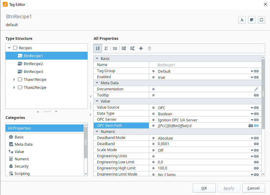

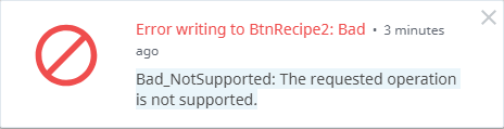

Hi!
I've successfully connected to a Mitsubishi PLC (FX5U) with IQ-F in Ignition. I can read the tags but i can only seem to write to words. When i try to write to a bool/bit i get "Bad\_NotSupported: The requested operation is not supported."
Could i have missed something here?
 ![bild](https://us1.discourse-cdn.com/inductiveautomation/original/3X/6/8/684627594e737c5f15d6fe6994d1c87d762b1f56.png)
 ![bild](https://us1.discourse-cdn.com/inductiveautomation/original/3X/f/f/ff8eaccf6dcb5f0cf65406ee927f5c6d433bd8aa.png)
**Author:** ![wilmerolsson](https://sea1.discourse-cdn.com/inductiveautomation/user_avatar/forum.inductiveautomation.com/wilmerolsson/32/85888_2.png) [@wilmerolsson](https://forum.inductiveautomation.com/u/wilmerolsson)\
**Post date:** [February 12, 2025, 7:23am UTC](https://forum.inductiveautomation.com/t/mitsubishi-tcp-slmp-writing-bad-notsupported/102232/2 "2025-02-12T07:23:59Z")
I found my own answer:
Optional Bit Index
Bit indexing can be specified on any integer data type to retrieve a boolean value at a bit position. Addresses with a bit index are read-only and any attempts to write to them will result in a Bad\_NotSupported error due to the MELSEC protocol.
A bit index cannot be specified for the following:
Non-integer data types (bool, float, double, and string)
Non-scalar addresses (arrays)
> **[Mitsubishi TCP Driver | Ignition User Manual](https://www.docs.inductiveautomation.com/docs/8.1/ignition-modules/opc-ua/opc-ua-drivers/mitsubishi-tcp-driver#addressing-in-the-designer)**
