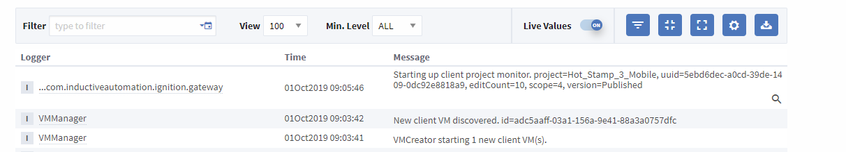

Good morning, I’m hoping someone here can help me with this issue.
Recently after adding a new device to my ignition gateway, our mobile clients take way too long to load. Theres no issue navigating the project once it is open, but that initial load takes on average two minutes. The log on the ignition gateway doesn’t show any issues, it just waits. Here is what the log says when I try to start a mobile client.
 ![image](https://us1.discourse-cdn.com/inductiveautomation/original/2X/7/7afd6ae9de2e430a33173a7148af56c8fa824962.png)
Any help would be greatly appreciated!

**Post date:** [October 1, 2019, 3:17pm UTC](https://forum.inductiveautomation.com/t/mobile-client-takes-2-minutes-to-start-up/28695/2 "2019-10-01T15:17:30Z")
Is your gateway connected to the internet, or air-gapped? You might be running into Java’s automatic certificate revocation checks.
**Author:** ![admora](https://avatars.discourse-cdn.com/v4/letter/a/ecd19e/32.png) [@admora](https://forum.inductiveautomation.com/u/admora)\
**Post date:** [October 1, 2019, 3:21pm UTC](https://forum.inductiveautomation.com/t/mobile-client-takes-2-minutes-to-start-up/28695/3 "2019-10-01T15:21:31Z")
Thanks for the help! Our gateway has internet access, and i’m not sure what air-gapped means. Our gateway and PLC’s are on a seperate network that is connected to our computer network through a firewall with a proxy bridge allowing the two networks to talk. I’ve tried moving the gateway to the same network as the mobile client and it still has the same issue. One thing i’ve noticed is that it always takes exactly 126 seconds to load a mobile client, and once it’s connected it runs smoothly.

After talking with Kurt from technical support he told me what my issue was. There is an issue with the mobile module and the web browser module interacting with each other. There were two solutions that kurt offered me:
1. Uninstall the web browser module if we were not using it.
2. Run the “Ignition Gateway” service (services.msc) with an administrator account. You can right click the “Ignition Gateway” and click the log on tab and enter an adminstrator account. Then restart your service.
