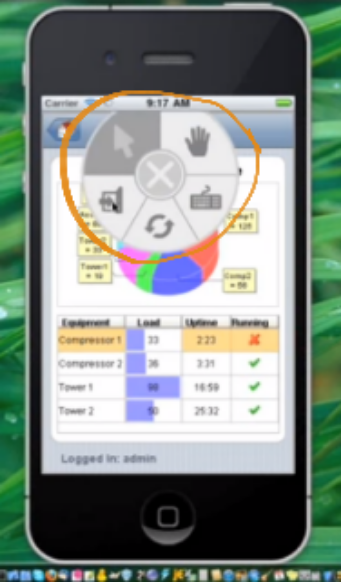

2)After launching the mobile application on the mobile devices(tried using Andriod phones and iphones), it was not able to access the mobile project context menu whereby if we press and hold on our touch-sensitive device, a circular menu will appear allowing us to switch between pointer and pan/zoom mode, as well as options for logging out and entering text input. Had checked the Ingition user manual under “Using the Mobile Option”
([Launching Clients - Ignition User Manual 7.8 - Ignition Documentation](https://docs.inductiveautomation.com/display/DOC/Launching+Clients))
and it seems that this feature is supposed to be available but we are unable to get the circular menu to appear while we tried to press and hold on the mobile smart phone devices.
Could you please kindly advise what are we missing or how could we get it to work?

From the youtube video …it shows press and hold on the smart phone and the circular menu will appear…exactly like what the manual says “press and hold” to get the circular menu…
Thus we didnt manage to get the circular menu popup and dont know how…so need to post here to seek advise…
Wonder if you are able to follow and get the same result as what the manual says(as per what i highlighted for that part of the manual) and what the video “Mobile Module - Inductive Automation” shows (
[- YouTube](https://m.youtube.com/watch?v=1xMiqkZfS3U)
Would you please kindly advise how do you get the circular menu on your mobile phone when you launch your application?

The ‘press and hold’ mobile shortcut menu no longer exists - it was removed not long after the mobile module launched due to various problems. The manual you were referencing is outdated and no longer actively maintained (since it’s for a closed branch, 7.8). The current manual is available here: [https://docs.inductiveautomation.com/display/DOC79/Ignition+User+Manual](https://docs.inductiveautomation.com/display/DOC79/Ignition+User+Manual)

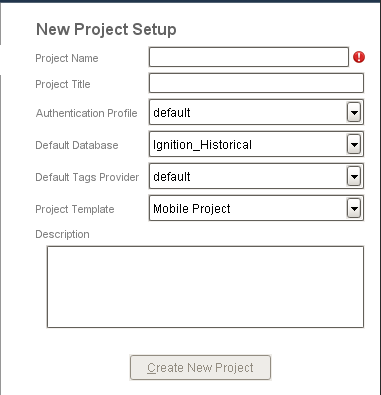

When you started your mobile project, did you use a mobile project template??
 ![](https://us1.discourse-cdn.com/inductiveautomation/original/2X/2/2bc8f68f11314d1cce14091a72229c5beda3808e.png)
If you didn’t I suggest you start again and use that otherwise everything will look weird.

Currently, is it possible to check this setting any where ?
I tried to check under localhost -\> Configure -\> Projects -\> Edit
But didnt find any related setting or information of this nature.

From everything i see I think you did not choose the mobile template when setting up your mobile project so I suggest starting a new project and this time select mobile template .
